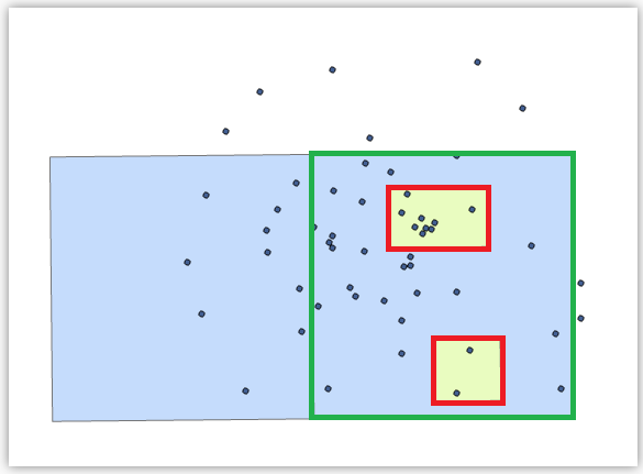

In this blog post we are going to use ArcPy to overcome this limitation. We will show that we can create a definition query where we filter points based on intersection with a polygon layer, but we also want to filter out points that intersect features in a second polygon layer. In our example, we want to create a definition query, using the spatial clause, where points intersect the green highlighted area below, but do not intersect the red areas.

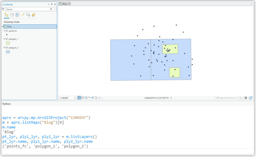

We access the open APRX we are working in, access the relevant Map, and we access each layer where pt_lyr is the layer we want to apply a definition query to using the spatial clause functionality, where the points intersect the right-most polygon in ply2_lyr, but do not intersect the polygons on ply1_lyr.
aprx = arcpy.mp.ArcGISProject("CURRENT")
m = aprx.listMaps("Blog")[0]
m.name
'Blog'
pt_lyr, ply1_lyr, ply2_lyr = m.listLayers()
pt_lyr.name, ply1_lyr.name, ply2_lyr.name
('points_fc', 'polygon_1', 'polygon_2')
