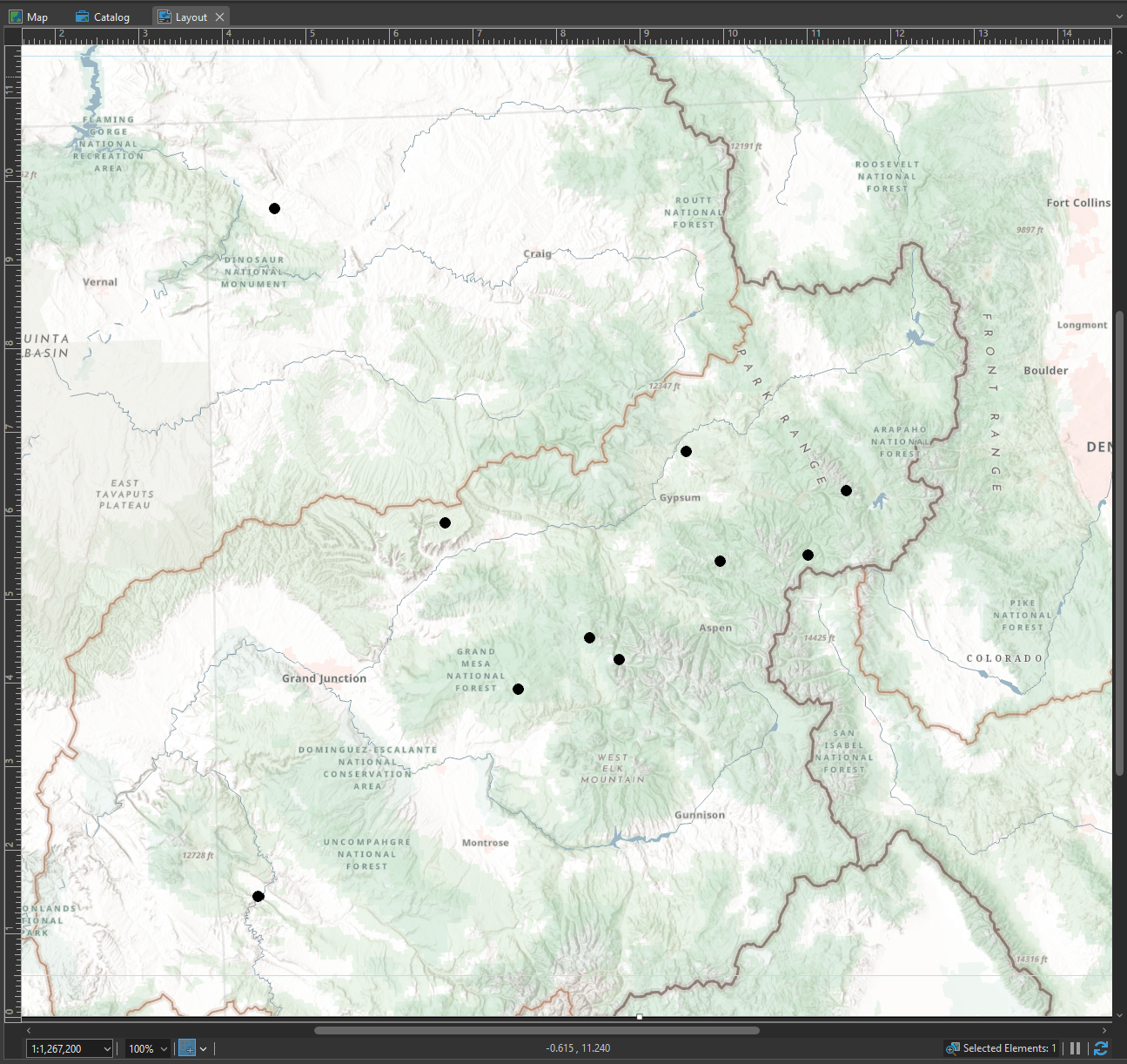

Example of the Layout view with a reference scale of 1:1,267,200 (1" = 20 mi).

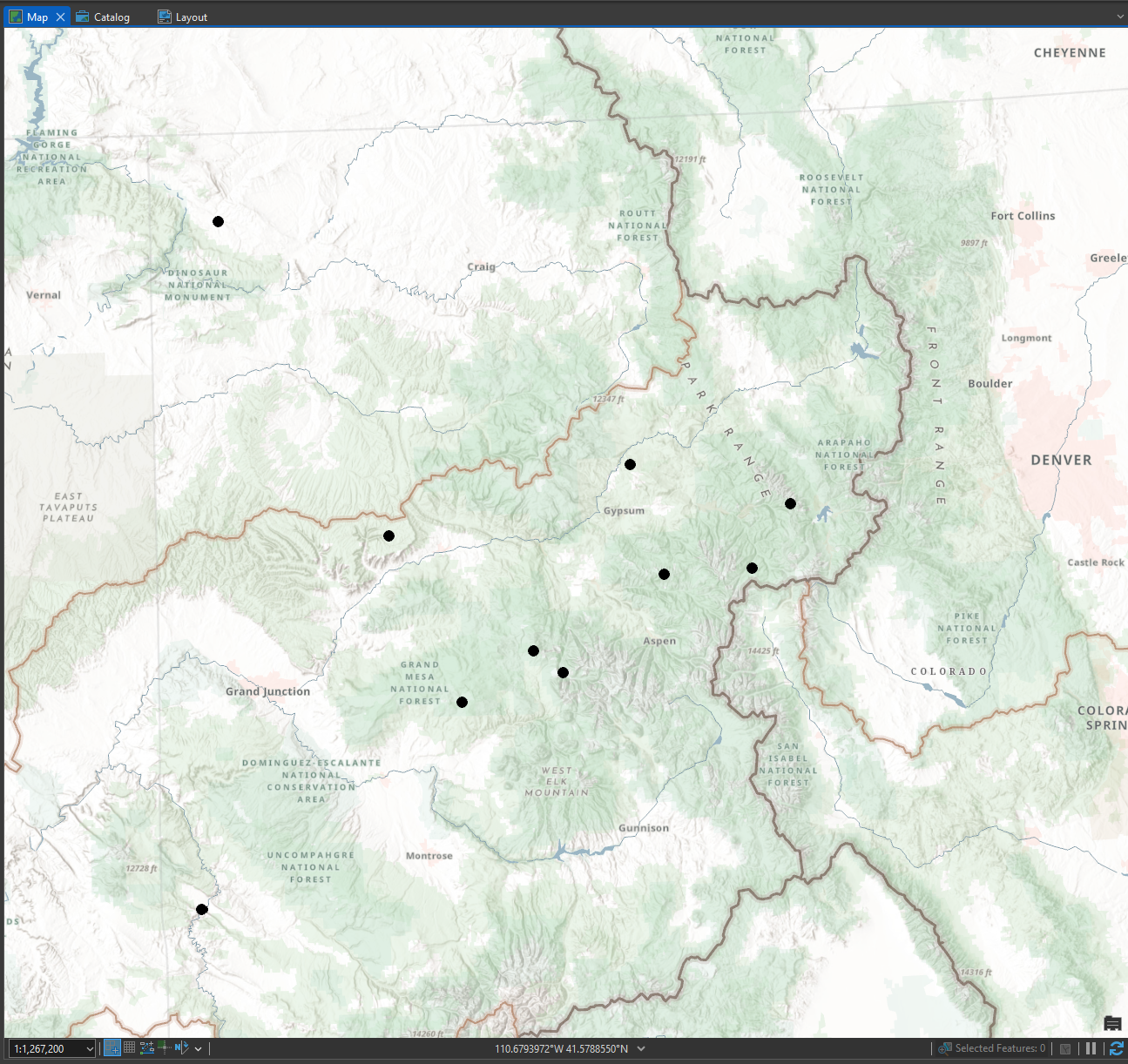

Map view at reference scale looks the same:

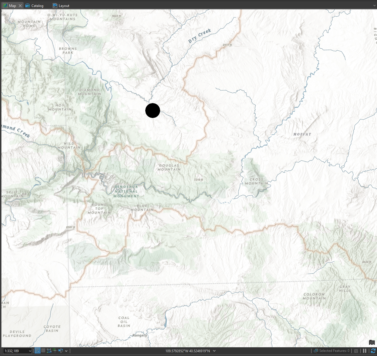

Map view at 1:316,800 (1" = 5 mi). Symbology honors reference scale, basemap does not:
