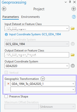

As one of those users, I often take data in WGS1984 or GDA1994 in the project tool as GDA2020, and accept the default transformation:

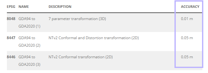

And I was yesterday-years-old when I learnt that there are much more accurate transformations, read the whole blog here

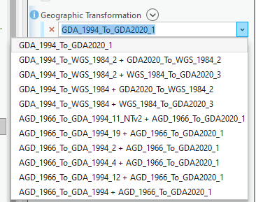

How can I confirm I suspect Pro 3.4 would have the newest transformation installed already (WKID 8447, 8446). Anyone know how to search by EPSG WKID in ArcGIS Pro?
I find Pro not so intuitive having a big drop down like below screen grab. I have done a visual inspection as long as my patience took me.
