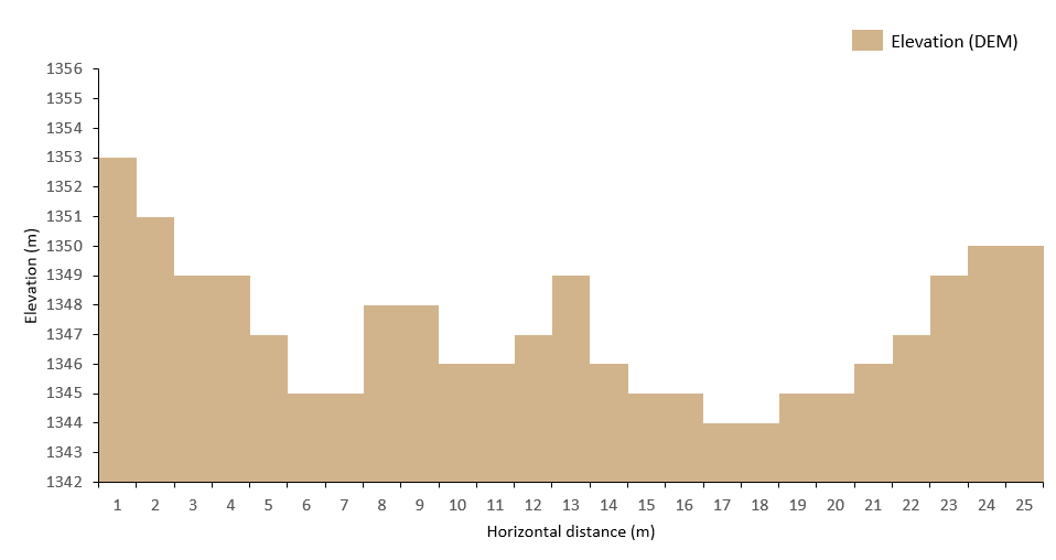

Figure 1 shows an elevation profile through a sink in a hypothetical DEM.
Figure 1. Elevation profile of a single sink.
Depending on the complexity of the terrain, sinks can be part of a nested structure that represents a larger depression area. A single sink is characterized by having a single lowest point whereas a nested sink can contain multiple low points within. Figure 2 below shows an elevation profile that has several nested sinks.
Figure 2. Elevation profile of nested sinks.

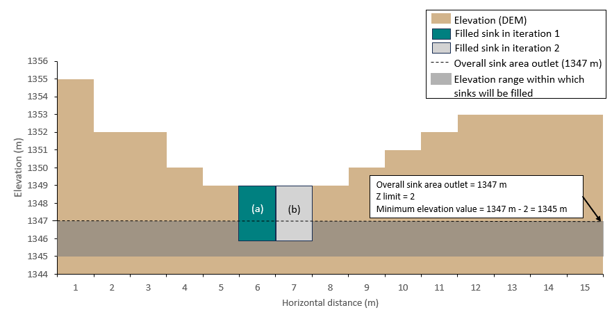

The Z limit parameter is used to decide which sinks will be filled. Leaving the Z limit parameter blank (default) will result in all sinks being filled. If a value is specified, it will be used to set the maximum difference allowed between a sink height and the overall sink area outlet height. For example, if Z limit is set to 1, assuming that the overall sink area outlet height is 1347 m, only sinks with depths between 1346 m and 1347 m will be filled. Any other sink that is out of this range will not be filled. If set to 2, then all sinks between 1345 m and 1347 m will be filled and so on.
Single and Nested sink fill process using Z limit parameter

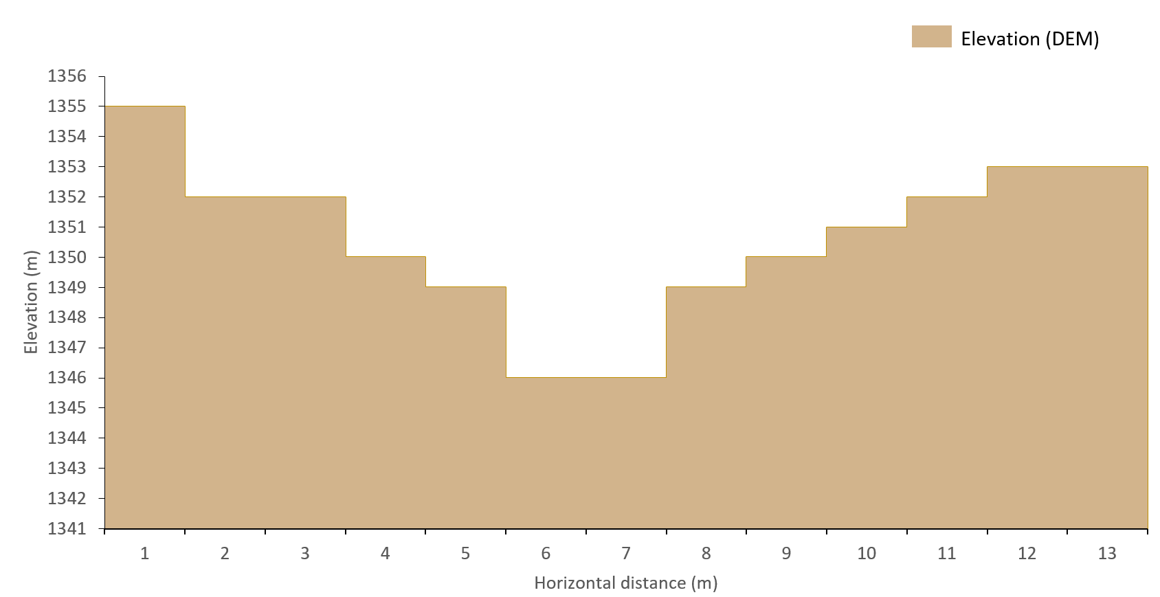

Using the Z limit equal to 2 example, a single sink (illustrated below in Figure 3) labeled (a) would be filled up to 1349 m which is the elevation value of the lowest adjacent neighbor. After having filled (a), the single sink labeled (b) would also meet the two conditions, and so it is also filled up to 1349 m.
Figure 3. Single sinks are filled using the Fill tool up to the elevation value of the lowest adjacent neighbor.

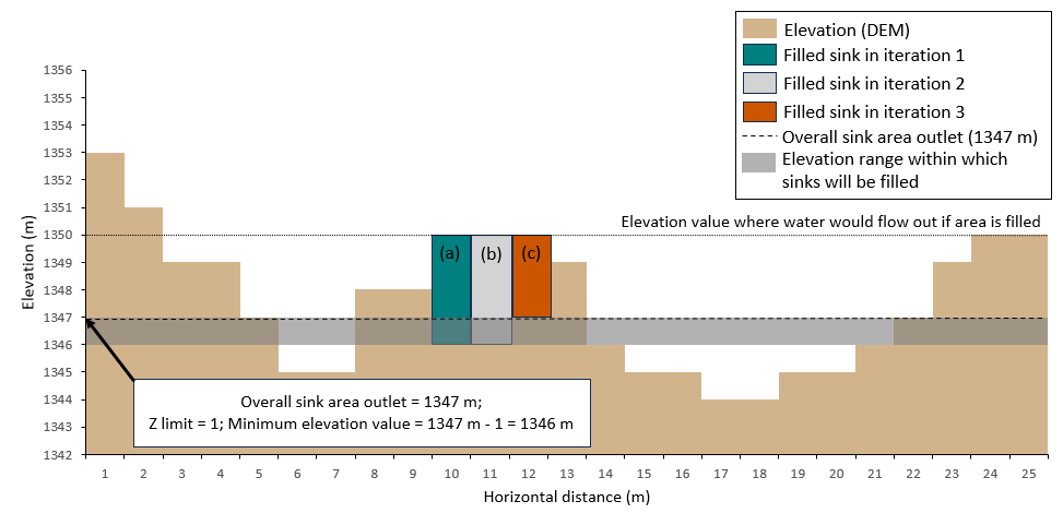

The same iterative process is applied to nested sinks - the only difference is the elevation value up to which a sink is filled. For nested sinks, this value is that of the overall sink area outlet. Like in the previous example, after a single sink is filled, neighboring cells may now meet the necessary conditions to be filled and thus will be filled. This is the case of sink labeled (c) in Figure 4 below. After (b) has been filled, (c) now meets Condition 2 – it has a lower elevation value than the lowest adjacent neighbor. Since it originally met Condition 1 (depth below the specified Z limit), it now meets both conditions, and it is filled.
Figure 4. Sinks are filled using the Fill tool up to the elevation value of the sink outlet.

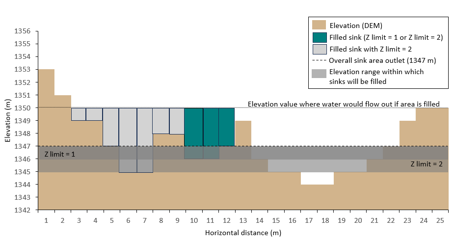

Note that the value of the Z limit parameter controls which sinks within the nested structure will be filled. If we increase the Z limit parameter value from 1 to 2, then other sinks and their neighbors meet the conditions, and they will be filled as shown in Figure 5 below.
Figure 5. Other sinks are filled using the Fill tool with Z limit = 2. All sinks that are filled with Z limit = 1 are also filled with Z limit = 2.
