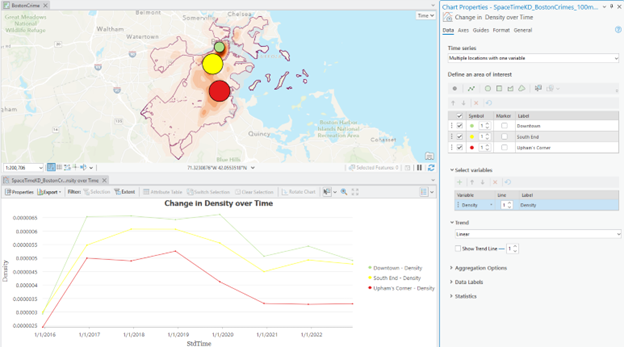

The Space Time Kernel Density tool allows you to use other multidimensional tools to better understand the density distribution. For example, with the density raster calculated using the Space Time Kernel Density tool, you can identify the temporal trends using the Predict Using Trend Raster tool or create a Dimension profile chart to understand the distribution of the multidimensional variable over time.
Use of Dimension Profile options to create a temporal distribution of Crime incidents in Boston
