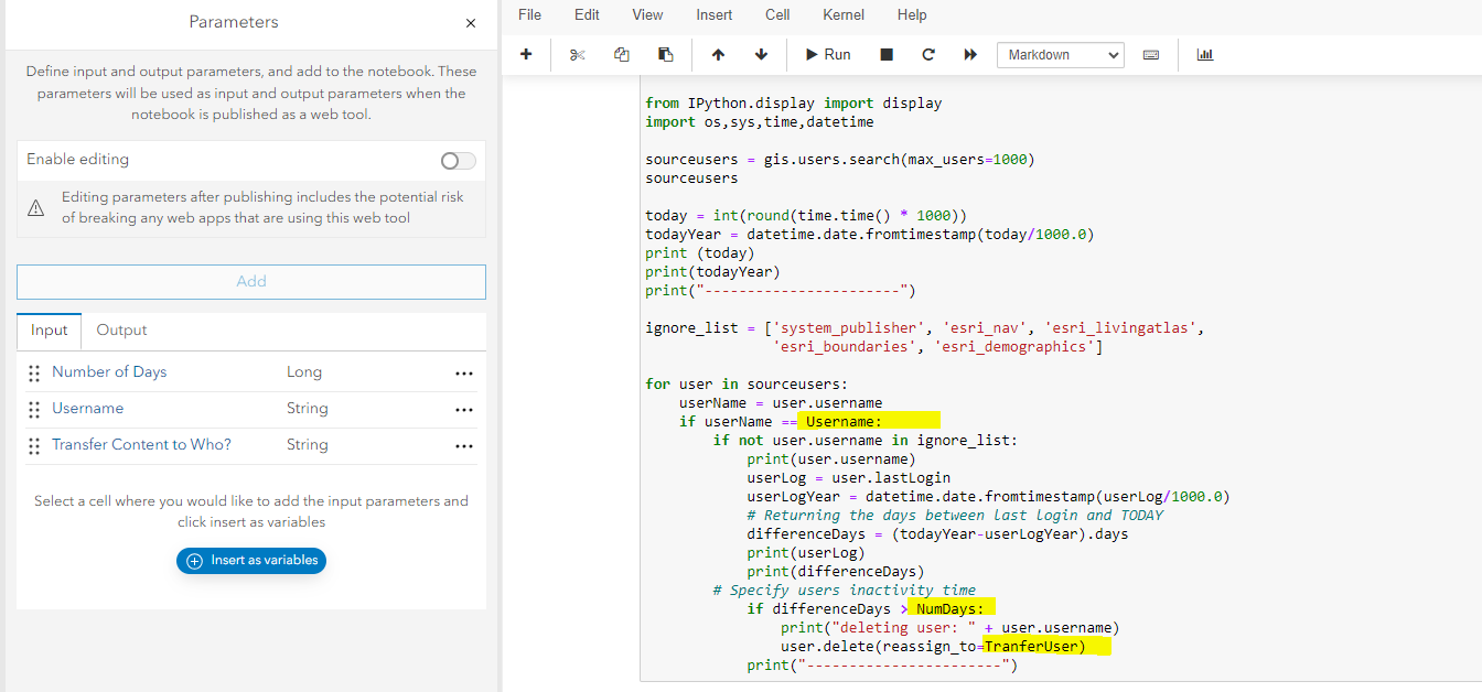

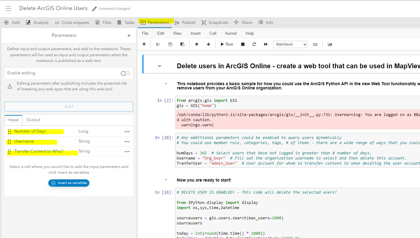

After I imported the script into the ArcGIS Notebook, I then created parameters:
I then made sure to update my script with the variable values for the parameters that were created:

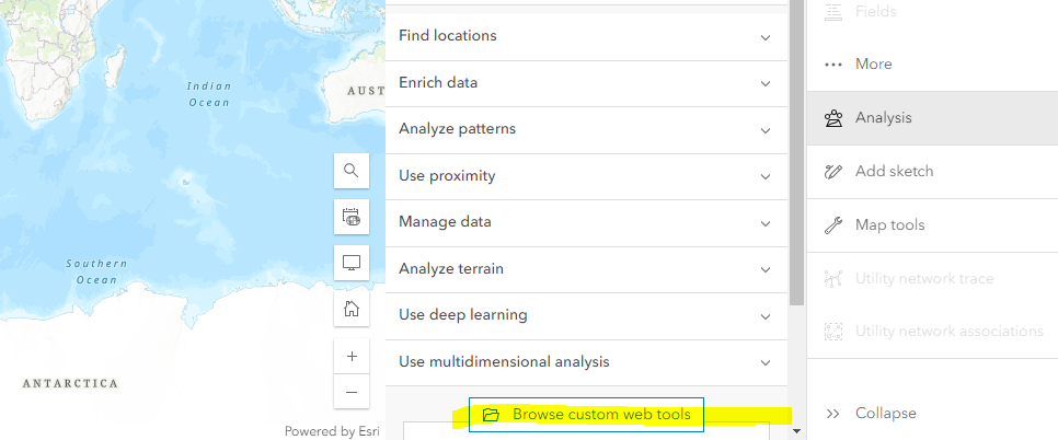

Within MapViewer - it's as simple as going to the Analysis pane, and then selecting the new 'Browse custom web tools' option:

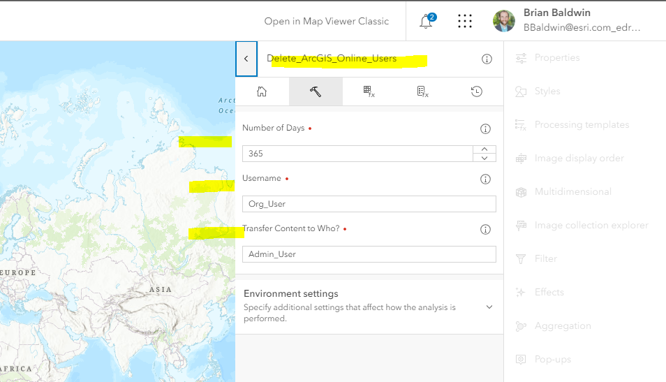

The UI is then populated with the parameters and values from your custom web tool - and you are ready to run it!
