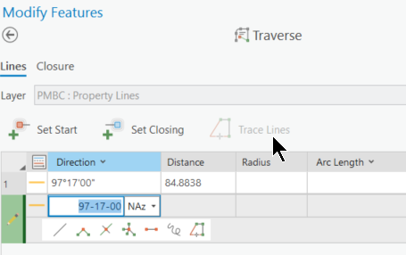

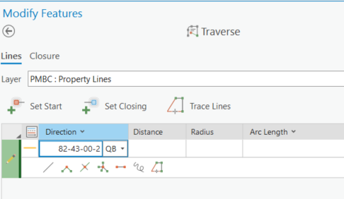

Choose QB, type direction.
As soon as I hit enter, the direction display changes to North Azimuth.

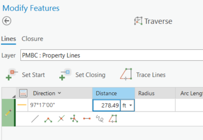

Choose ft, and type distance.
As soon as I hit enter, the distance display changes to meters.
In the next row, I have to choose the QB from the dropdown again.
If I choose QB and ft in Row 1, I would like the value displayed to stay in QB and ft (and not flip to NAz and meters), and for the QB/ft to persist in the dropdown for subsequent rows.
