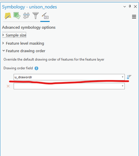

I have an app built on WPF + arcgisruntime 100.15 + mmpk.
There are a few symbols overlapped, I want to control the drawing order to make the important symbol on the top of the stack.
I am trying to bind a field in feature table to drawing order of a feature in feature layer. I can do this in ArcGIS pro as the picture shows. But, after I generated mmpk file and loaded it in wpf window with arcgisruntime api, the drawing order did not work as in ArcGIS pro. I want to ask is it possible to configure the drawing order for a feature in feature layer by binding a field or programming in code?
