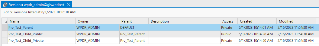

- User1 creates a parent version and sets it to Private.
- User1 creates a child version off the parent version and sets it to Public/Protected.

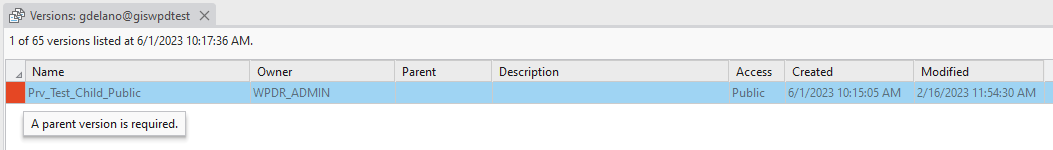

- User2 opens the Versions view in ArcGIS Pro. They do not see the parent version (expected behavior). They see the child version, and a red square with the hover text, "A parent version is required", appears next to the public/protected child version. The Parent field is blank since the parent version is private.

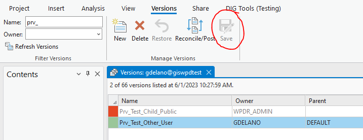

- User2 creates a new version, deletes a version, or renames a version. The changes are unable to be submitted because the 'Save' button is greyed out. This is due to the red square error described in #3.
- User1 changes the parent version from Private to Protected. User2 is now able to manage versions and save changes.
Parent version owner sees (User1, WPDR_ADMIN in image):
Other users see (User2, GDELANO in image):
Other user (User2, GDELANO) tries to create a new version:
