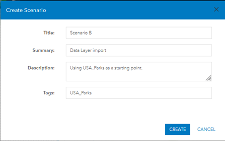

You can create, open, duplicate, or import scenarios from the Scenario drop-down arrow.
Step 9 – Fill in the new scenario’s details and click CREATE.
