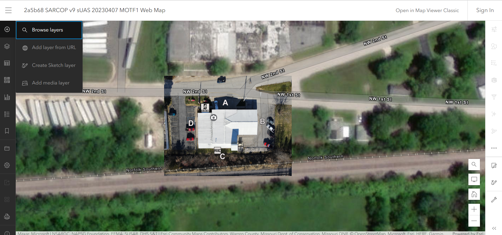

Most first responder sUAS pilots will not have the time or software to rapidly produce an orthomosaic and publish to ArcGIS Online (we often have to wait for specialists to arrive on scene or remote support to use Pix4D React or Drone2Map). This might take hours that are not available. The Media Layer is available in minutes and can buy some time while the "real imagery" gets baked.
Map (example only, not a building collapse) - https://napsg.maps.arcgis.com/apps/mapviewer/index.html?webmap=fbb0b80a4e8249f190976e9df02a5b68
Video https://screenpal.com/watch/c0fiYbVagre
For field observations we have been using QuickCapture and Field Maps to support users in the field. We recently attempted to use the new ArcGIS Online "Media Layers" to rapidly georeference an image and it worked very well. We could have it up in a web map within 5 minutes or less. HOWEVER - when attempting to use this layer in Field Maps we get the following error.
Domain: com.esri.arcgis.runtime.error
Code: 7005
Description: Layer type is not supported.
Solution: Support Media Layers in ArcGIS Mobile apps!
