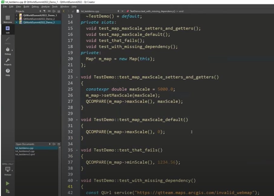

Qt Test functions
Qt Test can be used to efficiently manage a range of complex code. For example, when dealing with tests that use a lot of async code, James recommends using QTRY_COMPARE and QTRY_VERIFY test functions to allow more forgiving checks. QSignalSpy is another means that can be used to simplify your async tests. He also recommends ensuring test messages are good when using QVERIFY2 and QCOMPARE to remove ambiguity about failed tests.
Test dependencies can be another sticking point for failing tests. If a test requires a lot of set up, something could fail beyond the team's control before it even tests production code. For example, if a map test is checking it can load maps from local map packages successfully, the test will fail if the map package is missing from the system. In that case, the test failed to meet the test prerequisites, and should skip the test with QSKIP rather than fail it.
It’s an important distinction when reviewing test results: “Test failed” means something is wrong with the software. “Test skipped” means we did not run the test for some reason.
Tune in to the recording at 5:26 for a demo of an example of bad test code and how to fix it!

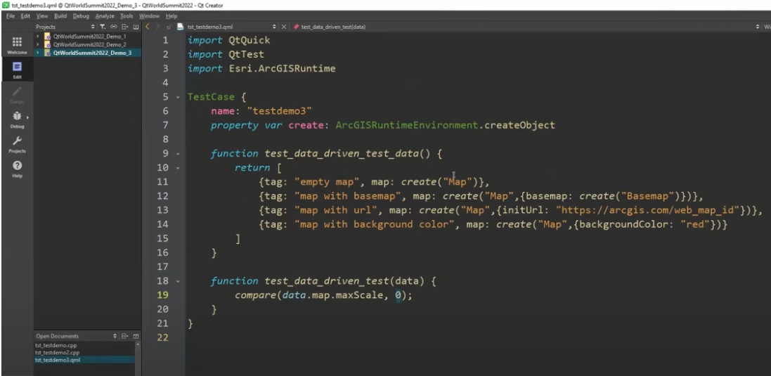

Mocking tests
One of the big wins for the Qt Maps SDK team was implementing mocked tests in order to mitigate a frequent cause of random test failures: services being offline unexpectedly . For example, in some cases tests are run against internal dev or QA services which are frequently updated and can be offline temporarily during such updates; offline enough to cause random test failures.
The team make use of dependency injection to simulate such services, and find it reduces their dependency on online services completely. An additional benefit is faster running tests since they don’t have to call out to an actual network.
However, one pitfall with the above approach is that online services do move on, whilst mocked services do not. So in the case where tests switch back to a live network, there might be some test failures.
It is recommended to check the live network occasionally rather than assuming mocked services can be run until problems come up.
Tune in to the recording at 9:15 for a demo of data-driven test code using different types of maps data, e.g. map with a basemap, map from a URL and an empty map!
