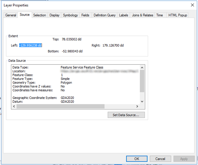

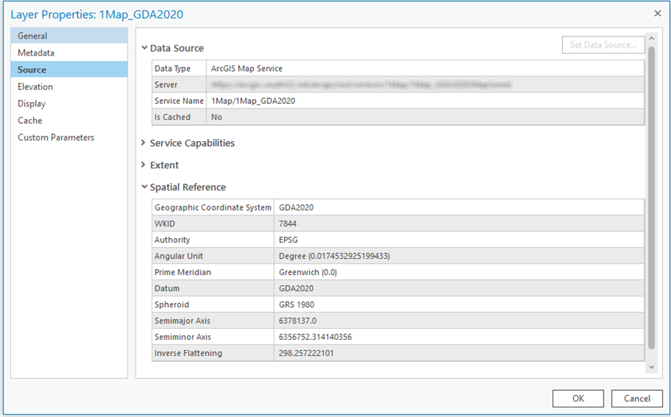

As shown below, ArcMap will honour the GDA2020 service spatial reference for both map and feature services. Pro will honour the GDA2020 service spatial reference for the map service.

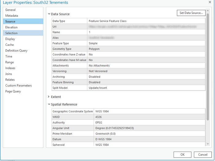

Pro will not honour the GDA2020 service spatial reference for the feature service, instead it uses the source spatial reference WGS84.
So feature services in Pro is the anomaly when it comes to spatial reference. This anomaly appears to be "as designed" by Esri Inc, as recorded in this bug https://my.esri.com/#/support/bugs/BUG-000134342. The alternate solution is to reproject the data source, which is not practical. Strangely the status is non-reproducible.
