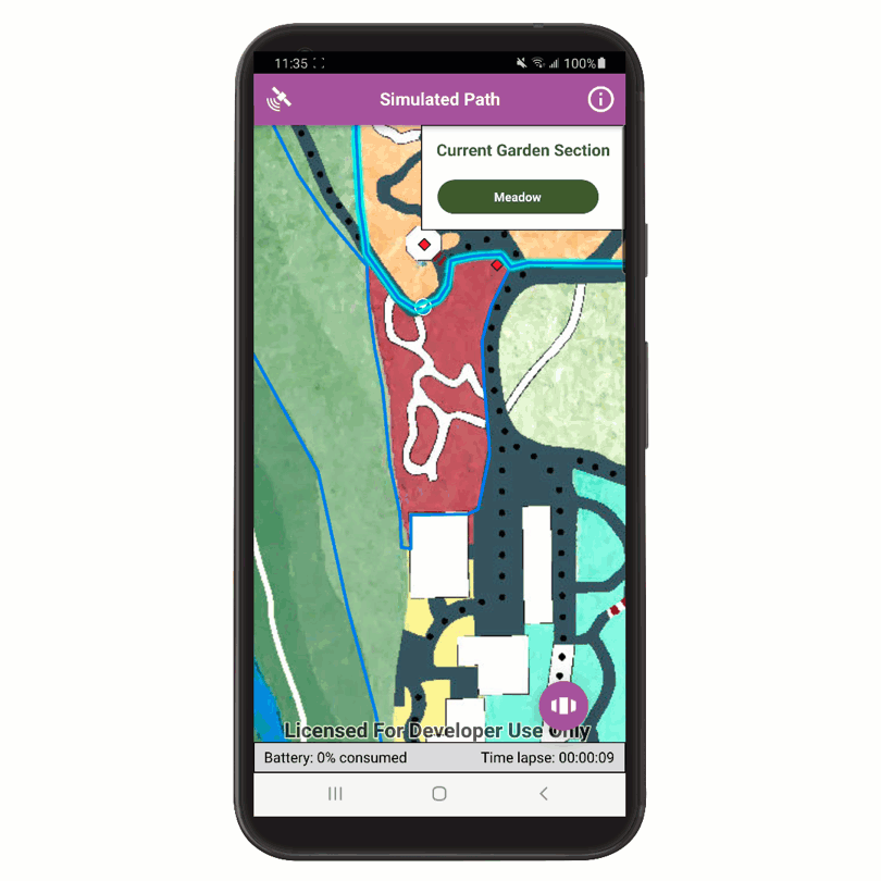

There are two samples within this application. One uses a simulated path that travels through Santa Barbara Botanic Gardens and another uses your current device's location and the OpenStreetMap Medical Facilities for North America feature layer.
When first opening the application, the Simulated Device sample will appear, and the simulated device will start moving through the Santa Barbara Botanic Gardens map. There are two features within this map, garden sections and garden points of interests. When within a feature geotrigger monitor parameter buffer, the geotrigger monitor will trigger a notification and populate a Garden Section or Point of Interest button. You can click the button to see some of that feature information pulled by the geotrigger monitor from the feature layer.

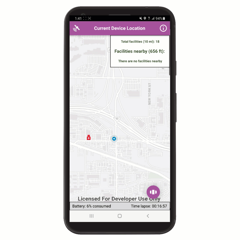

The Current Device Location sample will use your current device's location and the OpenStreetMap Medical Facilities feature layer stated above. Features within a set distance radius will be queried. After moving half the radius distance, features will be queried again based on the new current location. Just like the other sample, once your location is within the geotrigger monitor buffer, medical facilities buttons will appear. Clicking on the buttons will open a pane displaying the facility’s available information. This sample mobile app is intended for experiencing geotriggers while roaming the real world with a mobile device. So, get up, get out, and start moving towards these local medical facilities.
