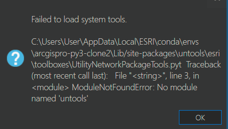

I have upgraded ArcGIS Pro to v2.8 and tried repeating the steps. This time I get a new error as shown below:
Now no geoprocessing tools are available at all.
In ArcGIS Pro v2.8 I have tried again to install untools via the command prompt but again I get the error above and no system tools are available.
