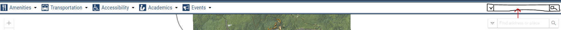

So, I'm building a webapp from scratch using ArcGIS API for JS 4.9 and I've got a DOM element 'nav-fullscreen', which spans the screen width and sits directly above my map view.
I am attempting to move the Search input box off the 'viewDiv' element and onto the 'nav-fullscreen' element. Like this...
Help documentation suggests that I use the container property in my Search widget constructor. Should be pretty simple right?
But when I try that, it takes the objects that were previously in 'nav-fullscreen' and places them in the Search Bar, rather than taking the search bar and putting it in the 'nav-fullscreen'. Seems backwards to me.
In this image, you can see that my 'nav-fullscreen' element has been moved into the Search Bar rather than vice versa.
