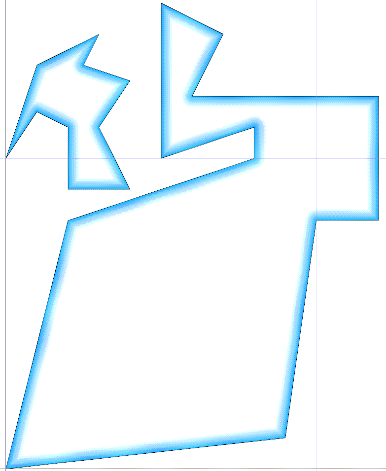

Laughing person ... before and after dissolve
Note the shapes aren't in order which makes it a challenge. You can do a lexicographic sort of the left-most coordinate to speed up the identification of adjoining shapes.

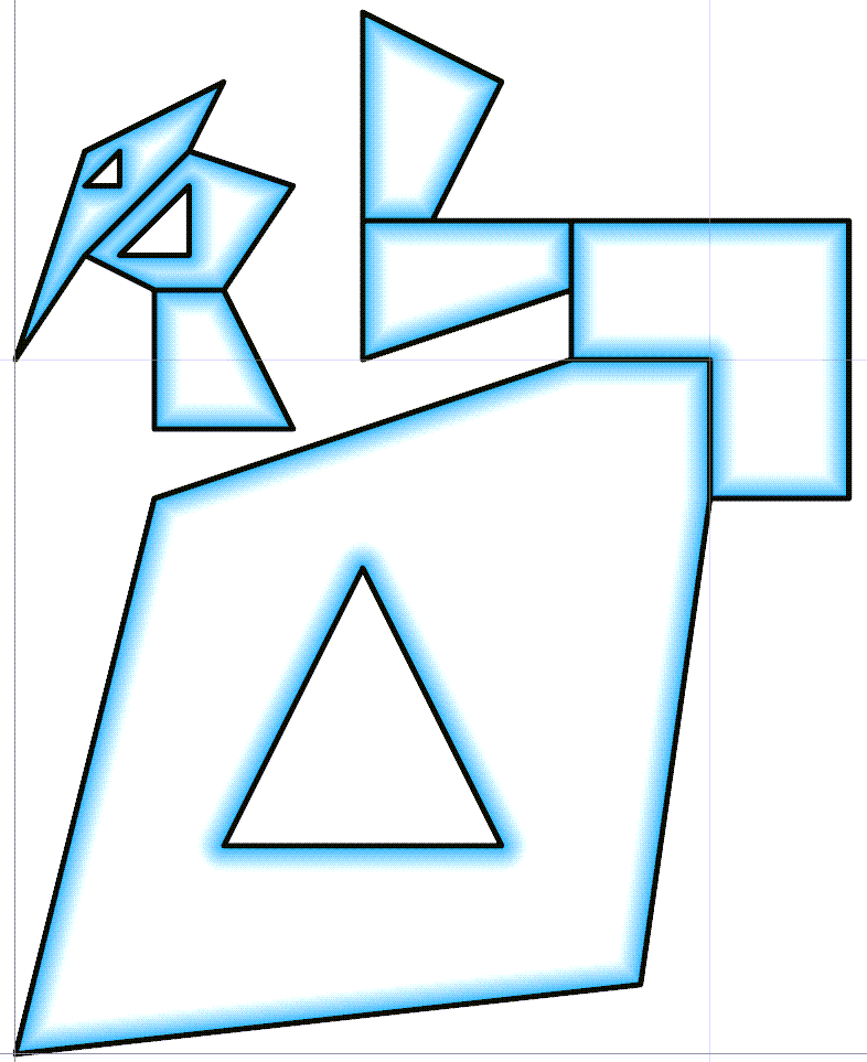

Bird on Dog ... before and after dissolve
This example shows two groupings of geometry. I chose the dump the holes option.

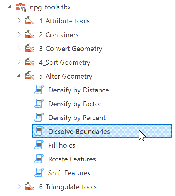

The Dissolve Boundaries tool
