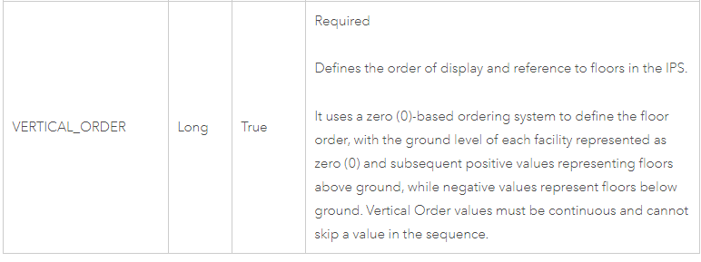

I set up the floor picker in my Field Maps app using the Indoors model. I'm having an issue with the VERTICAL_ORDER field. According to the Indoors documentation:

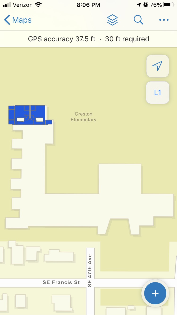

The problem is, when I navigate to a site, the first floor plan level I see is the lowest in the vertical order. For instance, I see lower level 1 (vertical order -1) instead of the ground floor (vertical order 0). This is not practical for field workers who will be entering sites on the ground floor, more often than not.

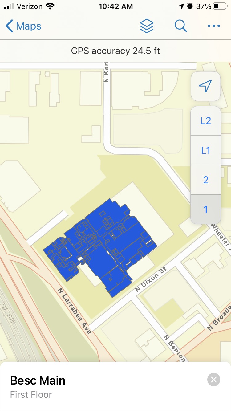

In addition to this, I ONLY see the lowest level in the floor picker. I have to click "L1" in the screenshot above before the other floors buttons are revealed. This will add extra confusion for field workers if they're only seeing the basement floor plan when they walk in the front door of the site.
I've made a workaround for this by assigning positive numbers to the lower levels that are greater than the highest above ground floors. So vertical order -1 becomes 3, vertical order -2 becomes 4, etc. But this also puts the floors out of order in the floor picker, because I'm seeing the highest numbers first, and the ground floor is at the bottom.
