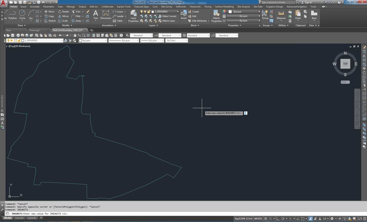

The only way that we can now fix this is by using Full version of AutoCAD to open the exported data. Then using "INSUNITS" command to set this to either (4) millimetres or (6) metres. This seems clunky and cumbersome and we should be able to specify this when exporting the data from ArcGIS Pro.
Data in AutoCAD 2019:
