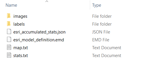

I created about 10 samples using the Label Objects for Deep Learning.
I saved the samples and the labels and then ran the Export Training data which created the images and labels folder, the other files required for the next step to train the model.

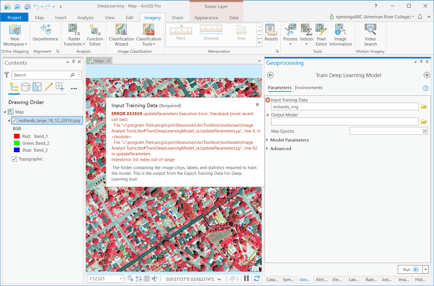

The input folder is never recognized (which is: \deep_learning\redlands_img that contains the above folders and files). I get the following error and cannot seem to fix it. Any help is appreciated. I am including my zip file of output.
