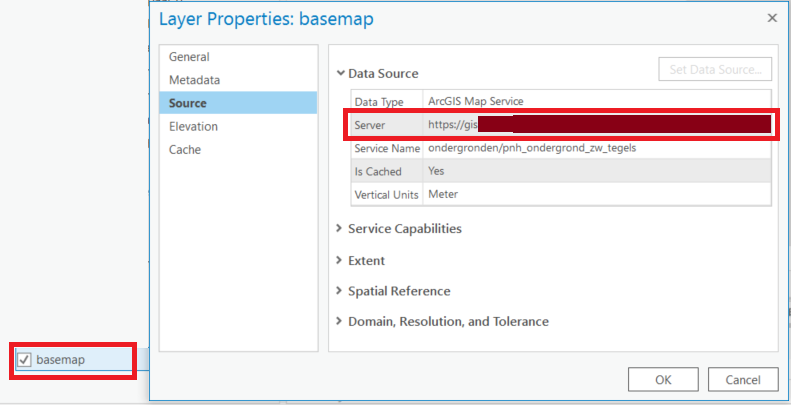

I would like to have the possibility to retrieve automatically (by using python) the url of a basemap/web layer which is in ArcGIS pro . As you can see in the image below, from the 'source' of the basemap layer I can manually retrieve the url of the basemap (web map layer).

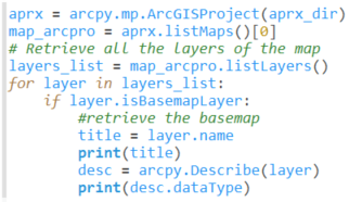

- I tried to retrieve the properties of the web layer by using arcpy.Describe but there was no method to evoke in order to retrieve the url of the web layer. I could retrieve though the name of the basemap and its dataType (InternetTiledLayer):
- I looked in the documentation for arcpy.Describe but it seems there are no specific methods that can be applied on web layers (ArcInfo Workstation Item properties—ArcPy Functions | ArcGIS Desktop ).
- I also tried to access the CONNECTIONPROPERTIES of the basemap layer but it appers that the connection properties are not applicable for web layers (Layer—ArcPy | ArcGIS Desktop ).
