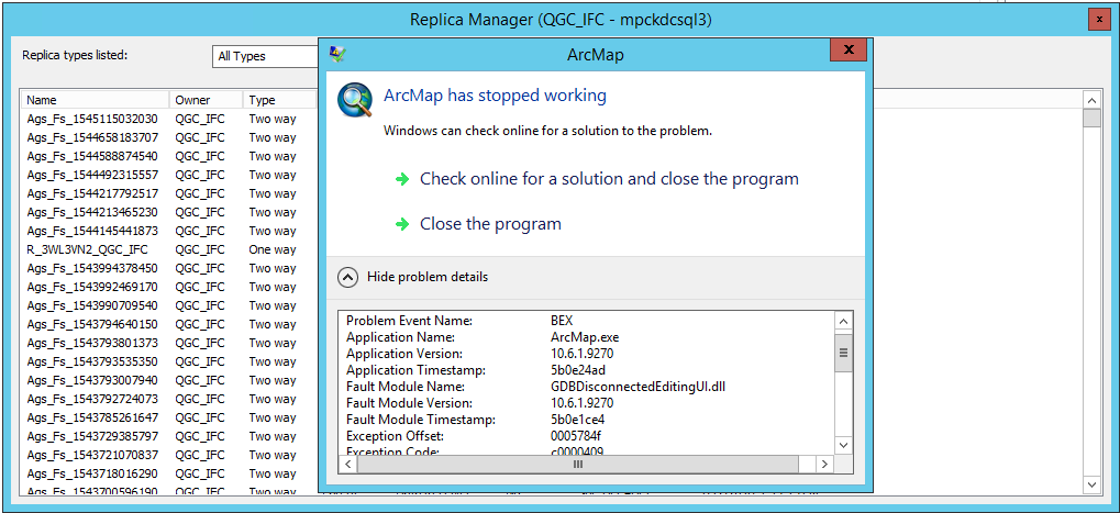

doing this manually is very time consuming and has dangers due to the interface in which you can remove a replica is not able to have a filter applied, and crashes when you sort the table more than once.

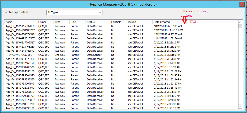

You can access using python the last sent and last received dates for a replica but you can't access when a replica was created? Neither can you un-register a replica using python, although I suspect this is a good thing as this has large disaster potential. We do need a better way to mange this potential mine field of performance and storage liability better.
Personally I would like a means to use the properties you can get from arcpy.da.ListReplicas to include the created date and be able to use the Replica Class properties in other tools or as a means to filter the replicas in a more stable dialog window. Potentially an ability to "TAG" a replica with the results of a python script would be incredibly helpful.
This BUG with the Replica Manager button has been consistent since 10.3 when I first found it. Still waiting for a fix other than don;t click on the column title more than once.
