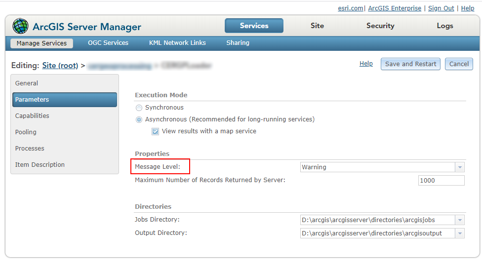

I have had a desire to set a switch/flag in geoprocessing scripts that log at a level corresponding to the setting in the server.
The 'Message Level' setting can be accessed using the python api.
I accomplished this via a small function as follows.
