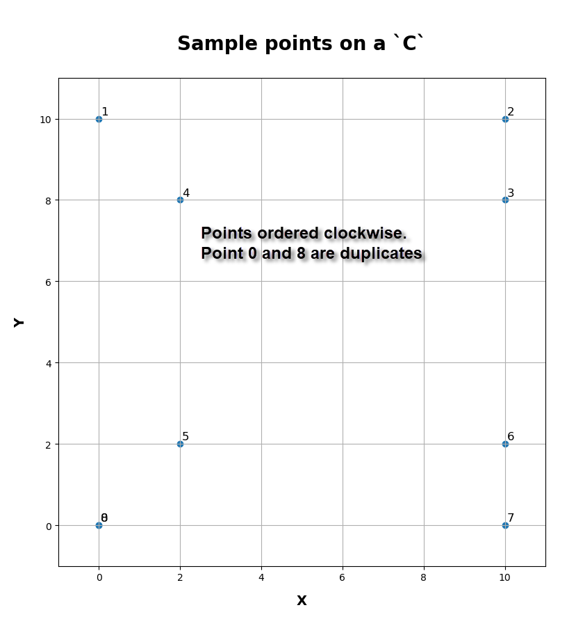

Start with a few points. The table and the graph below show what the arrangement is.
How was the table generated from the coordinates?
Every sequence needs an Id field, some x and y coordinates. The rest of the columns were calculated.
I will exclude the id column from the example, since all the other fields are decimal numbers.
- Make an empty array to hold the results
- Add the x and y coordinates (xs, ys)
- Calculate the sequential differences in the coordinates (dx, dy)
- Determine the segment lengths between the points (leng)
- Calculate the cumulative length of the path formed by the points
- Magic happens....
| Sample Data Points... |
id xs ys dx dy leng cumleng steps deltaX deltaY ---------------------------------------------------------------------------- 000 0.00 0.00 0.00 0.00 0.00 0.00 0.00 0.00 0.00 001 0.00 10.00 0.00 10.00 10.00 10.00 2.50 0.00 4.00 002 10.00 10.00 10.00 0.00 10.00 20.00 2.50 4.00 0.00 003 10.00 8.00 0.00 -2.00 2.00 22.00 0.50 0.00 -4.00 004 2.00 8.00 -8.00 0.00 8.00 30.00 2.00 -4.00 0.00 005 2.00 2.00 0.00 -6.00 6.00 36.00 1.50 0.00 -4.00 006 10.00 2.00 8.00 0.00 8.00 44.00 2.00 4.00 0.00 007 10.00 0.00 0.00 -2.00 2.00 46.00 0.50 0.00 -4.00 008 0.00 0.00 -10.00 0.00 10.00 56.00 2.50 -4.00 0.00 |

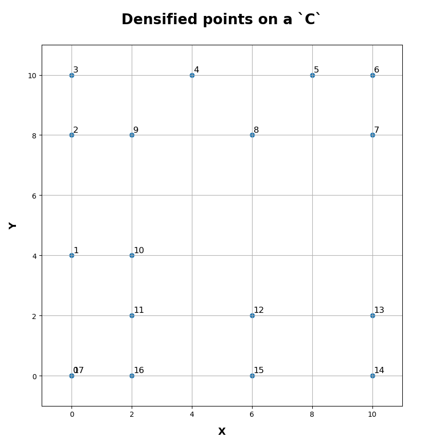

The final result is a sequence of points which represent the densified input pattern.
| Points ... translated/rotated for viewing. |
final.T array([[ 0., 0., 0., 0., 4., 8., 10., 10., 6., 2., 2., 2., 6., 10., 10., 6., 2., 0.], [ 0., 4., 8., 10., 10., 10., 10., 8., 8., 8., 4., 2., 2., 2., 0., 0., 0., 0.]]) |
