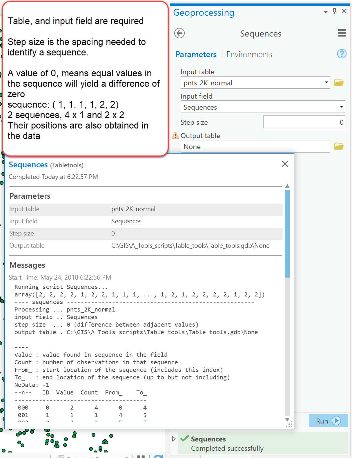

The dialog is fairly simple. Specify an input table and the field to query and a 'step size' which is the spacing between the values that you want to use to identify the sequence. The simplest case is to identify observations that are identical... that is, there sequential difference is zero.
An optional output table can be created to permit further analysis.
The input and output table for the Sequences field are shown to the right. The first sequence is four values of 2 beginning at ID number 0 and extending up to, but not including ID number 4.
Subsequent lines in the output table represent the different sequences. In this case, a sequence of 1 (value = 1) is followed by a sequence of 2 (value = 2) and another sequence of 4 (value = 1).

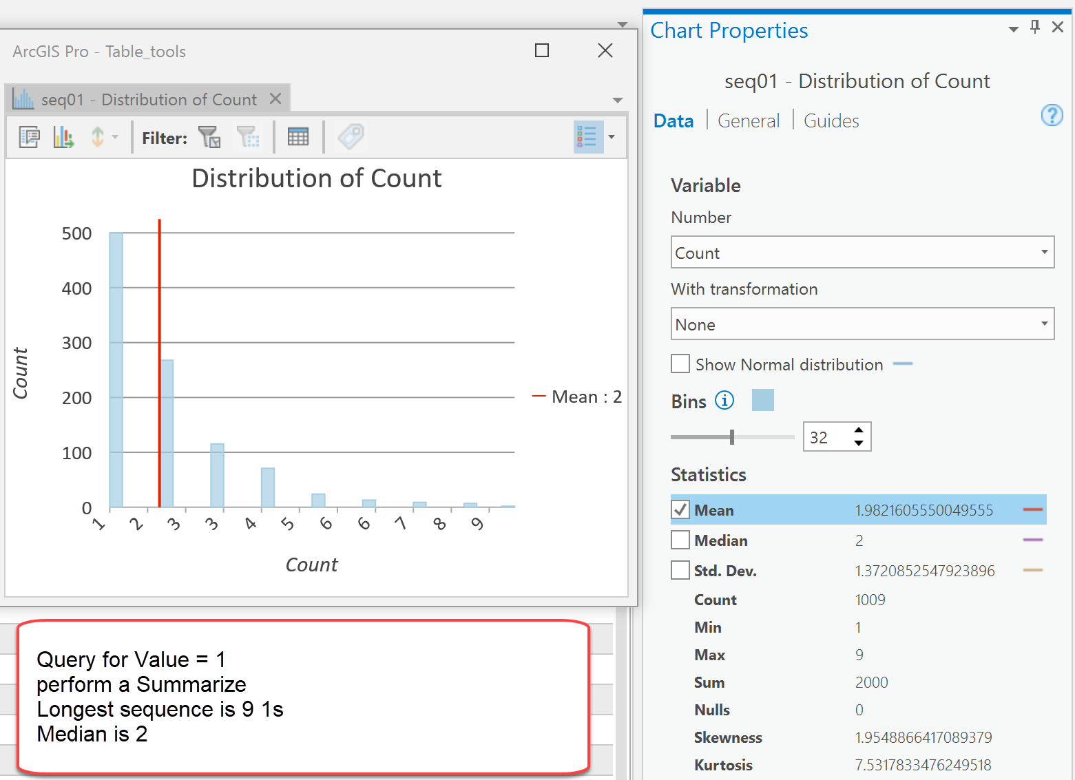

1 What is the longest sequence of value = 1?
2 What is the median?

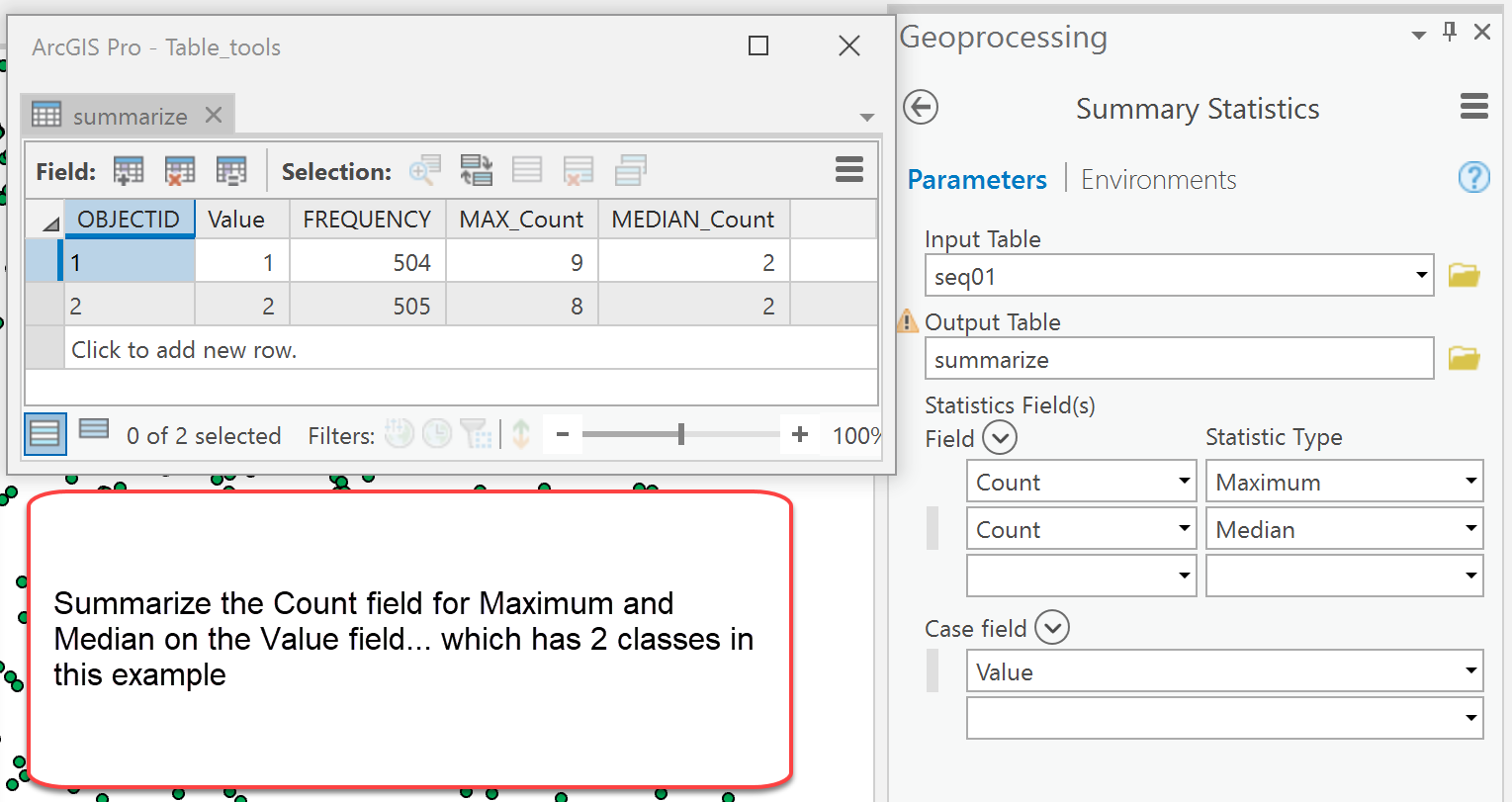

A simple Select By Attributes followed by a Statistics on the Count field and you are done.
Alternately, you can Summarize on the Count field based on the Value field.
