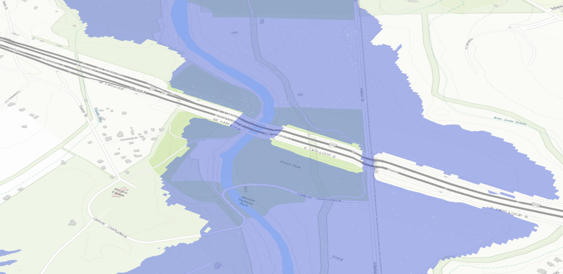

San Antonio, Texas 3D Flood Model generated with Esri 3D Risk Modeling Tools.

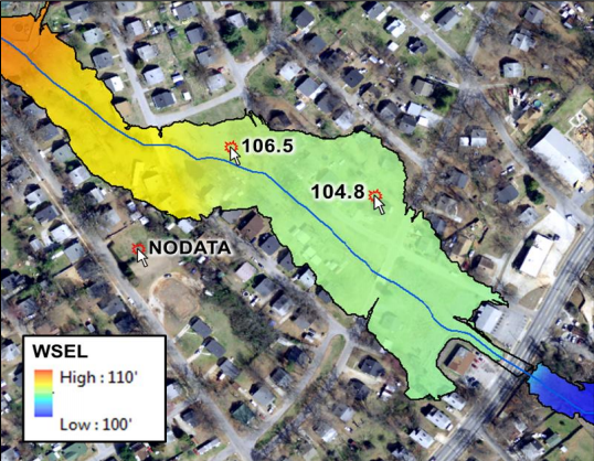

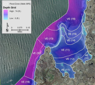

The 3D risk Tools require access to Water Surface Elevation Level (WSEL) Grids and Depth Grids.
Image Source: FEMA
Depth Grids must exist for levels 02%, 1% 2% 4%, 10% annual chance flood events

Generating the 3D flood Grid
1.) Run the Generate Water Hexbins GeoProcessing tool.
- Input a Polygon covering the area you want to generate a grid for
- The default Units of the input polygon specify the units of the grid area Size.
- Grid Area is in units square ex: 1000 sq feet shown below

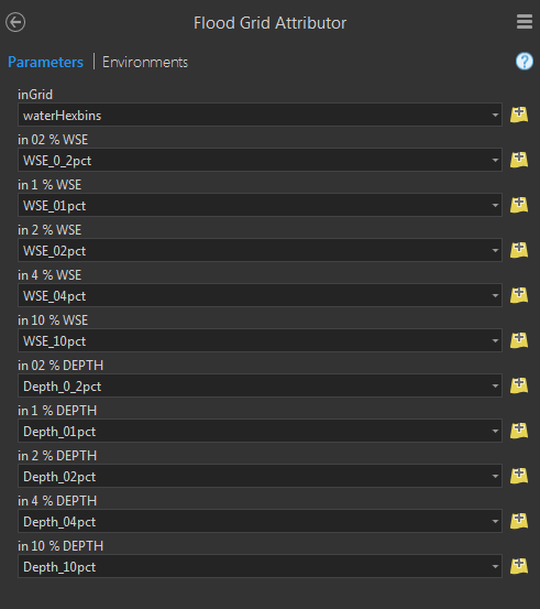

2.) Run the Flood Grid Attributor GeoProcessing tool.
- Input the waterHexbins Grid generated in the previous tool
- Input the % Water Surface Elevation and Depth Rasters

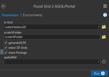

3.) Run the Flood Grid 2 AGOL/Portal GeoProcessing tool
- Input the Attributed Hexbin Grid from the previous process
- Set the Scratch folder for outputting files to
- Determine whether or not you want:
- Only Multipatches to be generated "retain 3D Grids"
- Only if interested in viewing in ArcGIS Pro
- Scene Layer Package
- 3D Format for sharing models on ArcGIS Online or Portal
- Share Package
- If you wish to Upload the Scene Layer Package to ArcGIS Online
- Publish the Layers on ArcGIS Online
- Add the Layers to a 3D WebScene

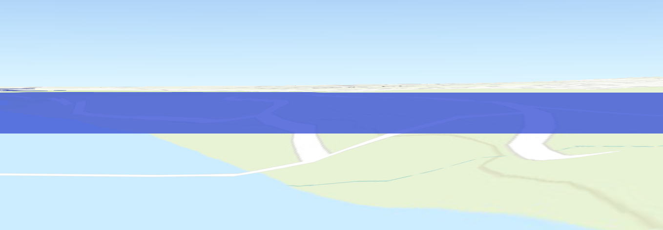

- Set Opacity to Layer
- Set Color to Blue

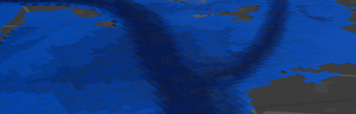

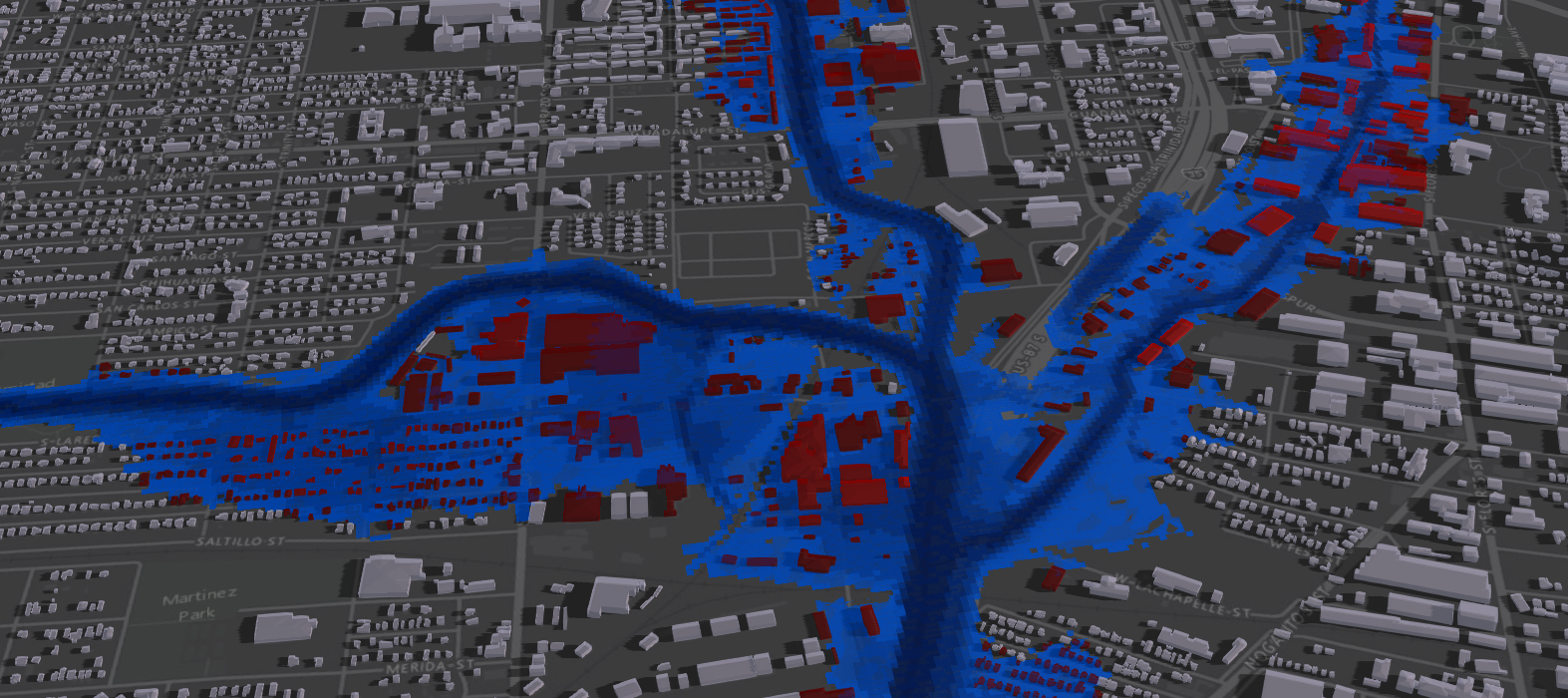

Result = 3D Gridded Plane denoting Water Surface Elevation attributed with Depth and other values.

Attributing Multipatch Features and Polygon Data with Flood Level attributes:
**Note: If you do not have 3D models use the Esri Local Gov 3D Basemaps Solution to Generate 3D Building from LiDAR.
** Esri can also accurately model your city in 3D from available LiDAR. Contact me: gtaylor@esri.com for more info...

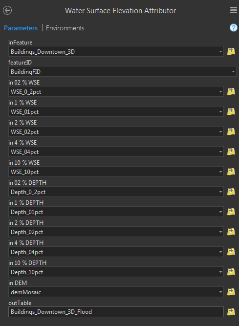

1.) Run the Water Surface Elevation Attributor GeoProcessing tool.
- input Multipatch Building or Polygon Feature
ex: 3D Building, Building Footprint, Parcel, Block Group etc...
- Select the FeatureID.
- FeatureID cannot be a String (Text) based value.
- Input the Digital Elevation Model (DEM) Raster

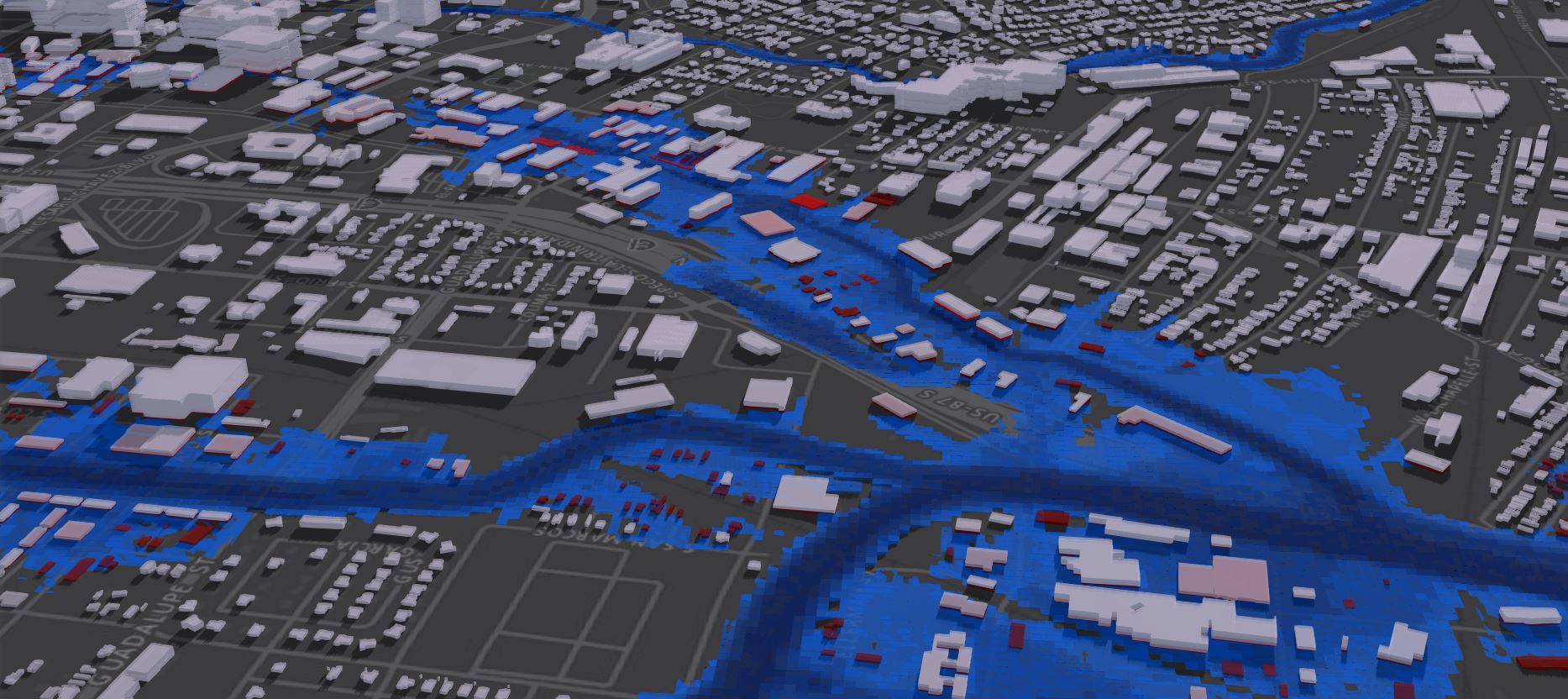

2.) Use Join or Relate Operations to Join the Table to the Footprints by FeatureID
3.) Use Symbology to color the 3D Building models by Attribute

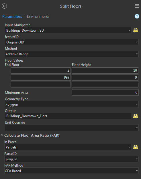

1.) Download the FacilityTools located here: https://community.esri.com/people/GTaylor-esristaff/blog/2016/01/13/create-floors-from-3d-building-models
2.) In the Facility Tools Toolbox run the Split Floors GP tool on the 3D Multipatch Buildings

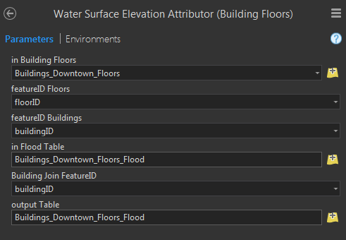

3.) In the 3D Risk Tools toolbox Run the Water Surface Elevation Attributor (Building Floors) GP tool
- Input Building Footprints
- Select floorID
- Select buildingID
- Input the Building Flood Table generated in Step one of this process
- Select the buildingID
4.) Use Join or Relate Operations to Join the Table to the Footprints by FeatureID

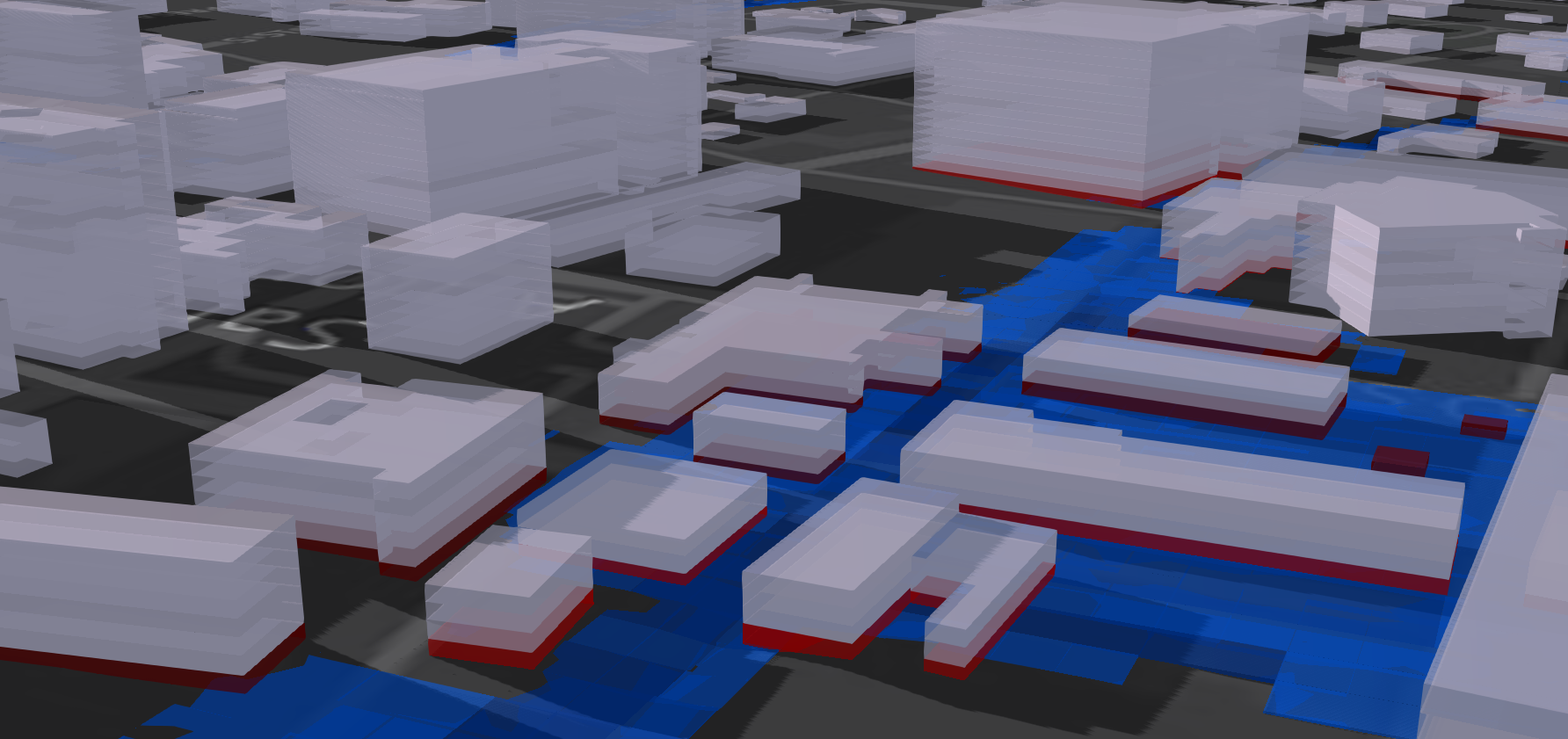

5.) Use Symbology to color the 3D Building models by Attribute
Results = 3D Buildings with floors attributed with flood data
