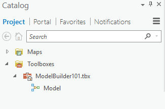

In ArcGIS, a model is stored inside a toolbox. In ArcGIS Pro, when you create a new project, a toolbox with the same name as the project is automatically created.
- On the Analysis menu, click ModelBuilder to open a model window.
Tip: You can also open a new model by right-clicking the toolbox folder in the Catalog pane and choosing New > Model.

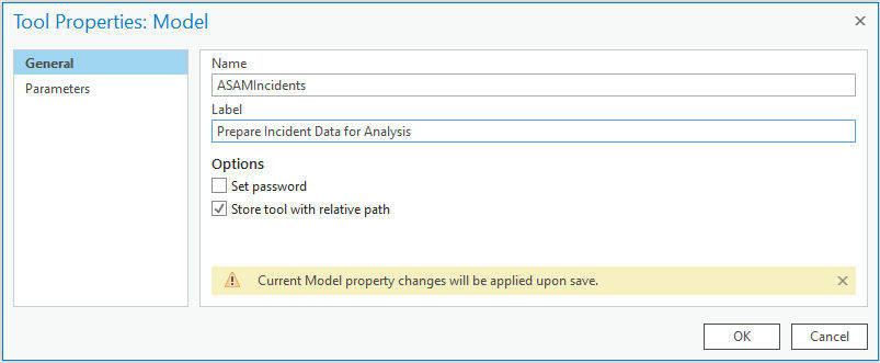

- On the ModelBuilder tab, click Properties.
In the General tab, the option to “Store tool with relative path” should be selected. This is what you want, because using relative paths prevents headaches down the road if your data gets moved around.
Set the properties below, then click OK.
- Name — the filename; no spaces allowed.
- Label — the plain-English name; spaces are fine.

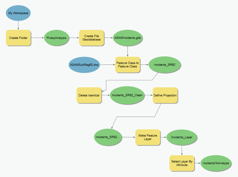

- A model consists of one or more processes. A process consists of three elements: input data, a tool, and the tool's output. Each output becomes input to the next process.

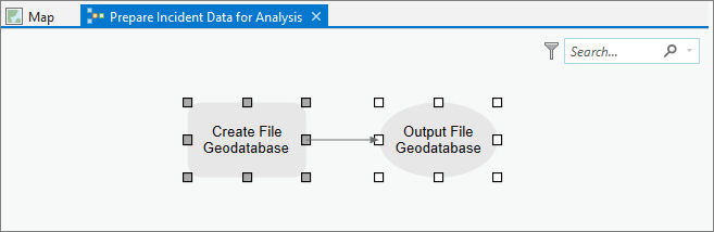

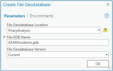

When you add a tool to a model (by dragging/dropping from the Catalog or Geoprocessing pane), its output element is also added and both elements are colored light gray. In model parlance, gray means "not ready to run." You need to double-click the tool and set its parameters.
- Tip: In a tool dialog box, a red asterisk means the parameter is required.
Once you click OK to set the tool parameters, the input element displays and the process colorizes, Oz-like.

It's fun to run a model inside ModelBuilder. As the model progresses, each process turns red and then gets a drop shadow. The drop shadow indicates the process has completed correctly. If a process turns gray, that means an error needs to be fixed and the model stops running. If you've validated, this shouldn't happen.
