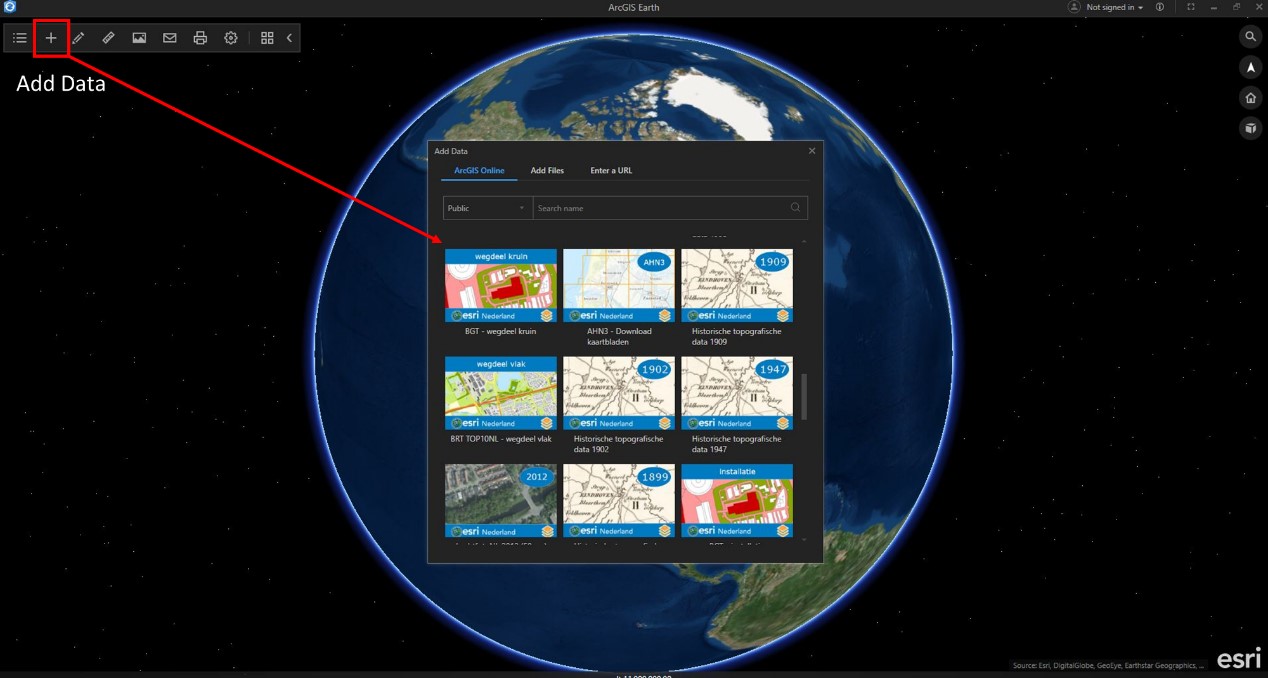

Accessing content from ArcGIS Online
ArcGIS Online is a collaborative web GIS where ArcGIS Earth users gain access to publicly available content shared by Esri and GIS users from around the world in the Living Atlas. ArcGIS Earth users can further enhance this experience by subscribing to ArcGIS Online, opening access to premium content and much more.

Publicly accessing content from ArcGIS Online
Accessing data with an ArcGIS Online Account

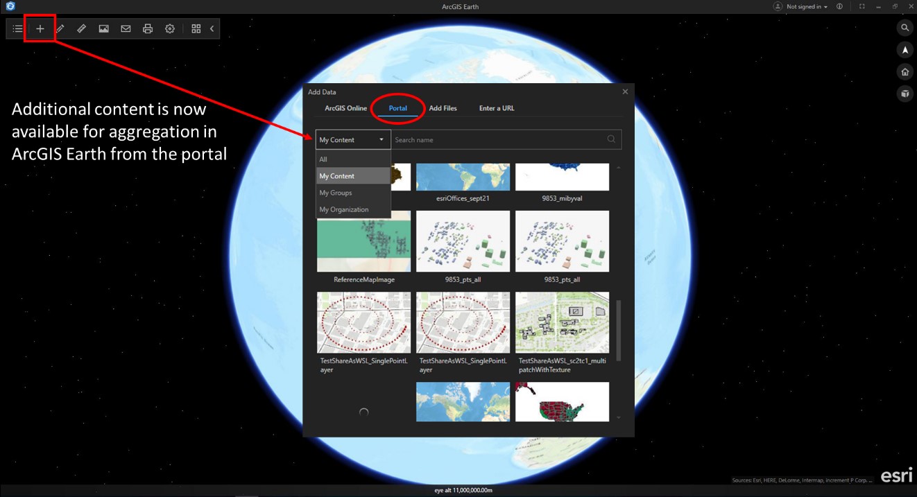

ArcGIS Enterprise
Along with ArcGIS Online, ArcGIS Enterprise is a key component of the ArcGIS platform. If you run your GIS from behind a firewall, in your infrastructure on-premises, ArcGIS Earth can access your organization portal(s) content directly and load this data on the ArcGIS Earth globe.

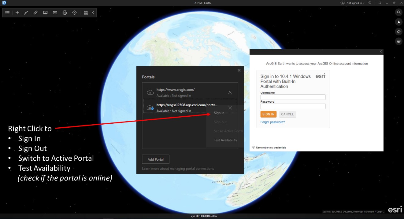

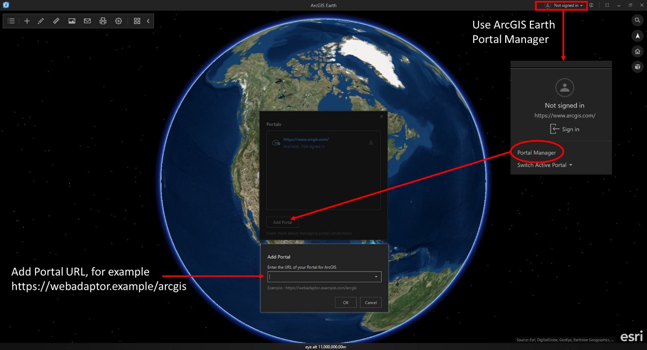

Adding your ArcGIS Enterprise Portal to ArcGIS Earth
Signing into a portal
Adding data from a portal

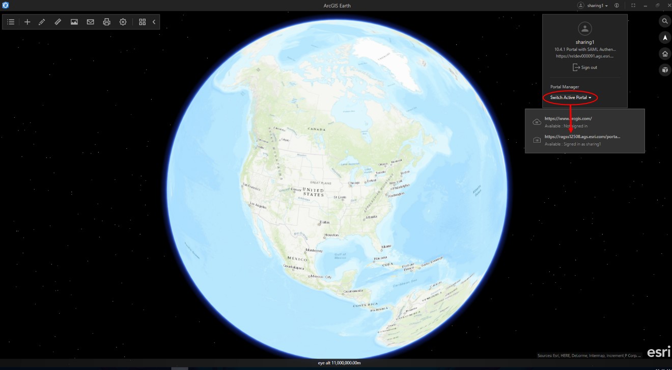

Add multiple portals and switch between them

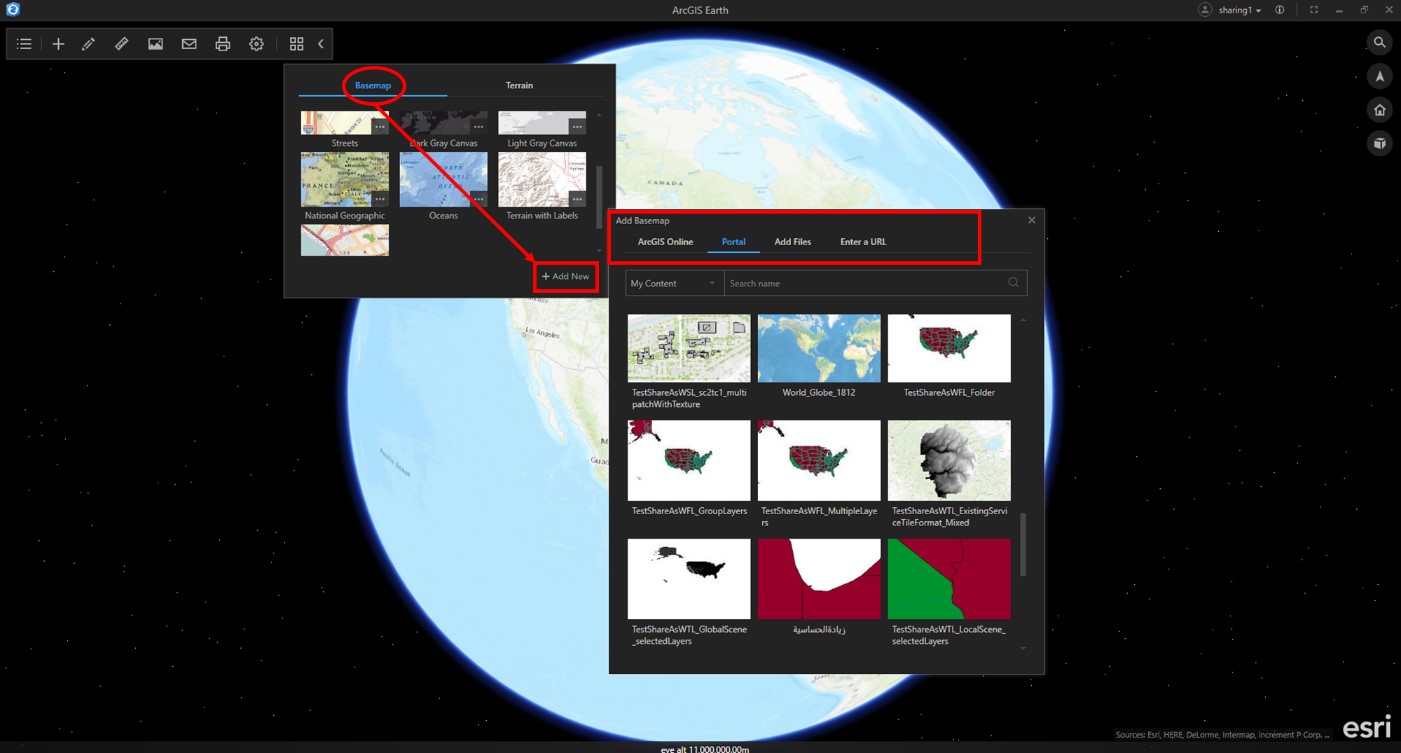

Basemaps and Terrain
ArcGIS Earth users also have the power to set the background geographic context and elevation reference by the same methods as adding data onto the globe. You can add all supported data types as a basemap, except shapefiles and CSV and TXT formats. Additionally, local raster data and elevation image services with LERC tile format can be added as terrain.
Adding Basemaps
Adding Elevation
