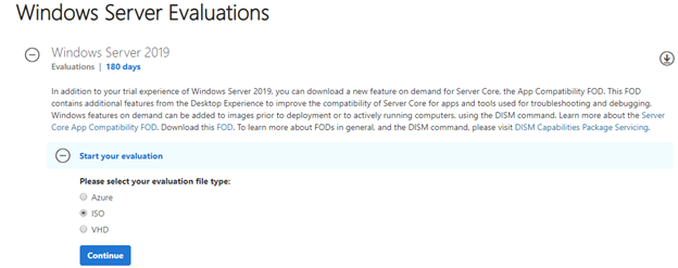

1.) Getting a Windows Microsoft 2019 ISO

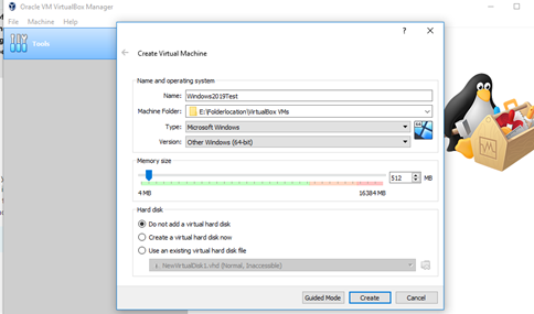

2.) Launch Virtual Box
-Top left of the VirtualBox UI, Machine, New.
- -Provide a Name
- -Provide a Machine Folder (where the machine's VirtualBox configuration will be placed).
- -Version: select Other Windows (64-bit)
- -Memory Size: select a relevant amount (like 5GB). Caution, this RAM is tied to the hosting system. You need to take into account how much RAM your system has before the allocation of RAM to the Virtual Box deployment.
- -Do not add virtual hard disk.

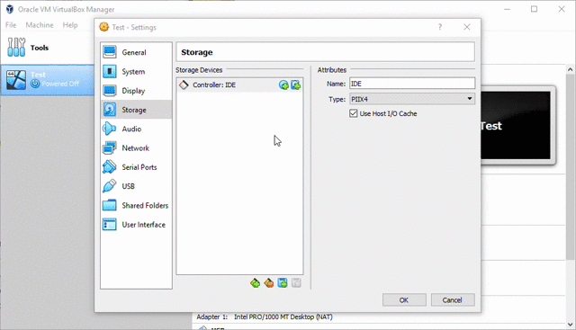

-Storage:
- Add Optical Drive (the ISO we downloaded from step 1).
- Add hard disk. Create a Virtual Hard Disk, Select VHD, Fixed Size, provide the location this VHD will be utilizing space from and provide the amount of disk space the VHD will be using.
- We want to make sure this hard disk is large enough to be able to host an Enterprise deployment. 70GB+ should be sufficient. Remember this is a clean deployment without any of the OS installation completed so true space available following our setup with 70GB is going to be about 58GB.
