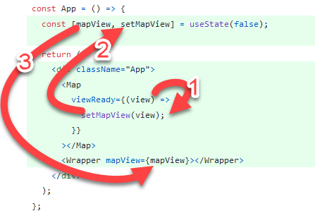

In index.tsx, we're importing the two components Map and Wrapper and including them in the JSX. The mapView is passed from the Map component to the Wrapper component via React state (see the setMapView call in the function that is passed as a prop to the Map component).

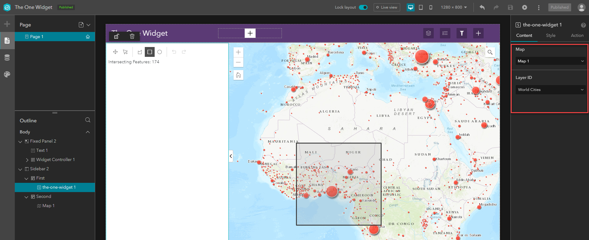

Then, in your Experience, add a Map widget. You probably want to choose a web map that contains the layer you're using in the Example App, but not totally necessary.
Next, create a Settings panel to allow the Experience Author to choose the Map and LayerID. To do this, create src/settings/settings.tsx and other required files, and use the JimuMapViewSelector and the JimuLayerViewSelector. Full code is here.
