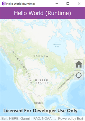

Save your work. If you choose to run your app at this stage (Alt+Shift+R), you will see the map launch and it will have two buttons, a home
and location
button.
Click the location button and see that the map will center on your current location. By default, the app is using your devices internal position source. To be able to use an external receiver, you need to be able to select one. We will next add a settings

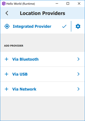

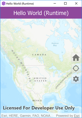

Run your app. See that there is now an additional button with the settings icon. Click on this button and see the settings page. On this page you can choose to connect to a GNSS receiver that is connected to your device.

- Save your work and run your app. See that the settings button is now the same color as the other buttons.

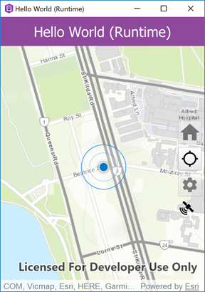

Also included in the GNSS Discover sample is a status button that indicates when the position source is connected, and when clicked, displays information coming from that position source. In the next step, we will add this button as is.
- After the last button in your app, paste the following (this code is also in the GNSS Discover sample)
GNSSStatusButton {
gnssStatusPages: gnssStatusPages

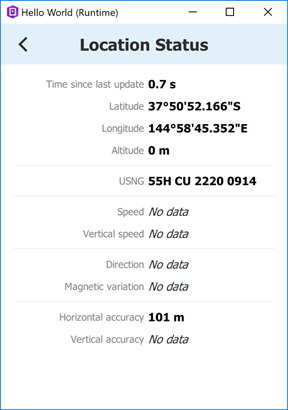

Save your work and run your app. The status button is only visible when the location is active, so first click the location button for the status button to appear. See that the status button has different styling to your other buttons. You can choose to style it as you wish. Click on the status button to see information coming from the position source.
