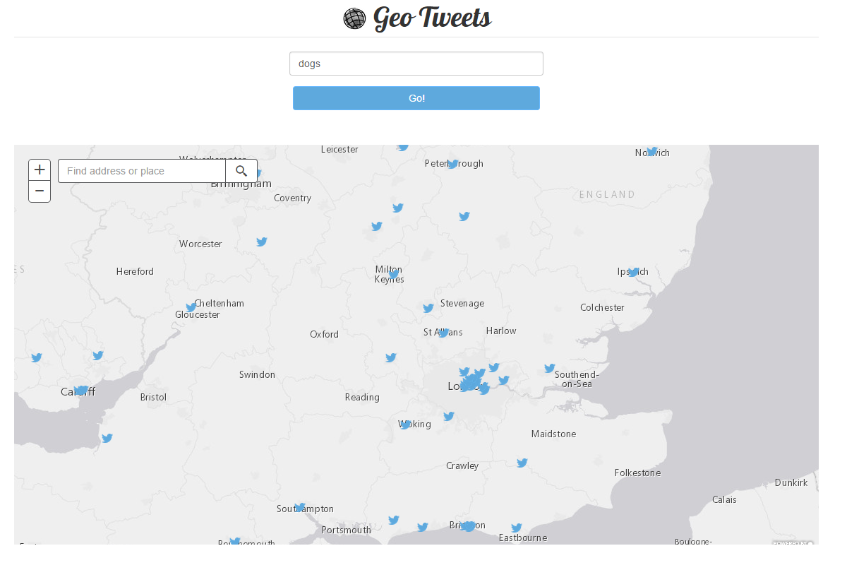

What is it ?
A simple map that allows users to search for tweets referring to a specific keyword in a given view extent. Currently the Twitter search API only allows you to pull back a maximum of 100 tweets, but it gives you a flavour for what you might be able to do if you had/have access to the Twitter firehose! The application also demonstrates how to do common tasks you might do in jQuery via Dojo. For example DOM querying, styling and AJAX using the requests module. This allows us as developers to not have to import an extra library whilst using the ArcGIS JavaScript API, reducing page weight.
What does it look like?

The Twitter Search API has a few parameters that we are specifically interested in, in this case, geocode and count. Geocode represents a latitude, longitude (note the order!) and radius that we are interested in returning tweets from (km or miles are accepted as units). In the case of this application we use the centre point of the map and then get the extent in kilometres divided by two as the radius. For the count we keep this capped at 100, as this is the maximum!
Frontend and ArcGIS JavaScript API
We firstly check if HTML5 geolocation, if so then we instantiate a map at that part of the the world using the provide coordinates. If not then we instantiate a map near the middle of the Earth (0, 30) at a reasonable zoom level (8). We also provide the user with a box to provide the keyword we are looking for. We then do an AJAX request to the PHP script 'gettweets.php'. As mentioned we pass it the latitude, longitude, radius and the Twitter keyword we're interested. This is returned back to our map, and we create a graphic for each of the tweets at its geotagged location (from the geo object of the Twitter API JSON payload). We do this using a PictureMarkerSymbol and also a suitable InfoTemplate with the users avatar, the content of the tweet and the date (again from the payload). The layout uses Bootstrap to allow for a responsive design that is suitable for most devices. We also make use of the Search widget, to allow for simple location finding for users.
