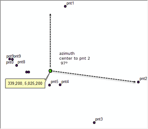

Azimuth to a specific point
Determine the azimuth to a specific point, for example, a point cloud's center.
Pre-logic Script Code:
<SPAN class="string token">""" azimuth_to(shape, from_x, from_y)
input: shape field, from_x, from_y
returns: angle between 0 and <360 between a specified point and others
expression: azimuth_to(!Shape!, from_x, from_y)
"""</SPAN>
<SPAN class="keyword token">def</SPAN> <SPAN class="token function">azimuth_to</SPAN><SPAN class="punctuation token">(</SPAN>shape<SPAN class="punctuation token">,</SPAN> from_x<SPAN class="punctuation token">,</SPAN> from_y<SPAN class="punctuation token">)</SPAN><SPAN class="punctuation token">:</SPAN>
radian <SPAN class="operator token">=</SPAN> math<SPAN class="punctuation token">.</SPAN>atan<SPAN class="punctuation token">(</SPAN><SPAN class="punctuation token">(</SPAN>shape<SPAN class="punctuation token">.</SPAN>centroid<SPAN class="punctuation token">.</SPAN>X <SPAN class="operator token">-</SPAN> from_x<SPAN class="punctuation token">)</SPAN><SPAN class="operator token">/</SPAN><SPAN class="punctuation token">(</SPAN>shape<SPAN class="punctuation token">.</SPAN>centroid<SPAN class="punctuation token">.</SPAN>Y <SPAN class="operator token">-</SPAN> from_y<SPAN class="punctuation token">)</SPAN><SPAN class="punctuation token">)</SPAN>
degrees <SPAN class="operator token">=</SPAN> math<SPAN class="punctuation token">.</SPAN>degrees<SPAN class="punctuation token">(</SPAN>radian<SPAN class="punctuation token">)</SPAN>
<SPAN class="keyword token">if</SPAN> degrees <SPAN class="operator token"><</SPAN> <SPAN class="number token">0</SPAN><SPAN class="punctuation token">:</SPAN>
<SPAN class="keyword token">return</SPAN> degrees <SPAN class="operator token">+</SPAN> <SPAN class="number token">360.0</SPAN>
<SPAN class="keyword token">else</SPAN><SPAN class="punctuation token">:</SPAN>
<SPAN class="line-numbers-rows"><SPAN></SPAN><SPAN></SPAN><SPAN></SPAN><SPAN></SPAN><SPAN></SPAN><SPAN></SPAN><SPAN></SPAN><SPAN></SPAN><SPAN></SPAN><SPAN></SPAN><SPAN></SPAN><SPAN></SPAN><SPAN></SPAN></SPAN>
expression =
azimuth_to<SPAN class="punctuation token">(</SPAN>!Shape!<SPAN class="punctuation token">,</SPAN>from_x<SPAN class="punctuation token">,</SPAN> from_y<SPAN class="punctuation token">)</SPAN><SPAN class="line-numbers-rows"><SPAN></SPAN></SPAN>

Line direction or Azimuth to Compass Bearing
Can be used to determine the direction/orientation between two points which may or may not be on a polyline. Provide the origin and destination points. The origin may be the 0,0 origin or the beginning of a polyline or a polyline segment.
<SPAN class="keyword token">def</SPAN> <SPAN class="token function">line_dir</SPAN><SPAN class="punctuation token">(</SPAN>orig<SPAN class="punctuation token">,</SPAN> dest<SPAN class="punctuation token">,</SPAN> fromNorth<SPAN class="operator token">=</SPAN><SPAN class="token boolean">False</SPAN><SPAN class="punctuation token">)</SPAN><SPAN class="punctuation token">:</SPAN>
<SPAN class="string token">"""Direction of a line given 2 points
: orig, dest - two points representing the start and end of a line.
: fromNorth - True or False gives angle relative to x-axis)
"""</SPAN>
orig <SPAN class="operator token">=</SPAN> np<SPAN class="punctuation token">.</SPAN>asarray<SPAN class="punctuation token">(</SPAN>orig<SPAN class="punctuation token">)</SPAN>
dest <SPAN class="operator token">=</SPAN> np<SPAN class="punctuation token">.</SPAN>asarray<SPAN class="punctuation token">(</SPAN>dest<SPAN class="punctuation token">)</SPAN>
dx<SPAN class="punctuation token">,</SPAN> dy <SPAN class="operator token">=</SPAN> dest <SPAN class="operator token">-</SPAN> orig
ang <SPAN class="operator token">=</SPAN> np<SPAN class="punctuation token">.</SPAN>degrees<SPAN class="punctuation token">(</SPAN>np<SPAN class="punctuation token">.</SPAN>arctan2<SPAN class="punctuation token">(</SPAN>dy<SPAN class="punctuation token">,</SPAN> dx<SPAN class="punctuation token">)</SPAN><SPAN class="punctuation token">)</SPAN>
<SPAN class="keyword token">if</SPAN> fromNorth<SPAN class="punctuation token">:</SPAN>
ang <SPAN class="operator token">=</SPAN> np<SPAN class="punctuation token">.</SPAN>mod<SPAN class="punctuation token">(</SPAN><SPAN class="punctuation token">(</SPAN><SPAN class="number token">450.0</SPAN> <SPAN class="operator token">-</SPAN> ang<SPAN class="punctuation token">)</SPAN><SPAN class="punctuation token">,</SPAN> <SPAN class="number token">360</SPAN><SPAN class="punctuation token">.</SPAN><SPAN class="punctuation token">)</SPAN>
<SPAN class="keyword token">return</SPAN> ang<SPAN class="line-numbers-rows"><SPAN></SPAN><SPAN></SPAN><SPAN></SPAN><SPAN></SPAN><SPAN></SPAN><SPAN></SPAN><SPAN></SPAN><SPAN></SPAN><SPAN></SPAN><SPAN></SPAN><SPAN></SPAN><SPAN></SPAN><SPAN></SPAN></SPAN>
Convert Azimuth to Compass Bearing
Once the Azimuth to a particular point is determined, this can be converted to a compass direction, centered in 22.5 degree bands. The type of compass can be altered to suit... see script header.
