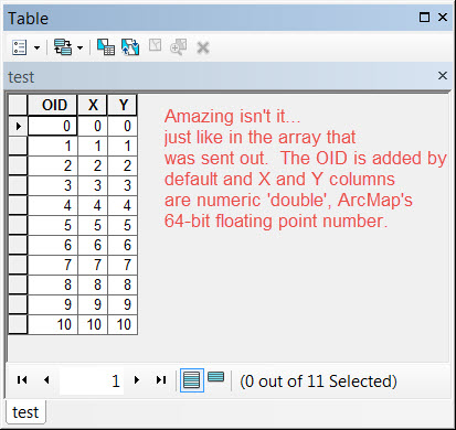

This just a quick example of how to use existing arrays and export them to tables. In this case I will use arcpy functionality to produce a dBase file. Numpy can be used directly to produce text files as well.
To begin with:
- two arrays of X and Y values are created in the range 0-10 inclusive (ie 11 numbers),
- a data type is specified (dt)... in this case I assigned 'X' and 'Y' to the columns and specified a 64-bit floating point number,
- an array, XY, is create using some fancy zipping of the original arrays with the specified data type,
- ArcPy is imported, an output table is created using the data access module's NumPyArrayToTable.
- Now for the magical reveal

Now for the reveal...
Bring it back you say? Nothing could be easier.
>>> in_array = arcpy.da.TableToNumPyArray(out_table,['OID','X','Y'])
>>> in_array
array([(0, 0.0, 0.0), (1, 1.0, 1.0), (2, 2.0, 2.0), (3, 3.0, 3.0),
(4, 4.0, 4.0), (5, 5.0, 5.0), (6, 6.0, 6.0), (7, 7.0, 7.0),
(8, 8.0, 8.0), (9, 9.0, 9.0), (10, 10.0, 10.0)],
dtype=[('OID', '<i4'), ('X', '<f8'), ('Y', '<f8')])
