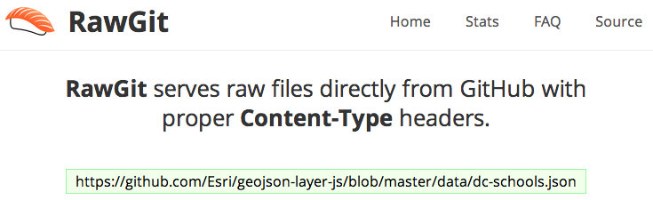

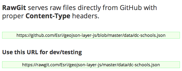

So how do you get a static reference to your files? It's easy as 1-2-3!
2. Go to RawGit and paste in the url
| 3. Use the dev or prod RawGit reference in your apps |
Here's an example where I used RawGit to change a bunch of the local .js and .geojson references so I could run the app from fiddler.
