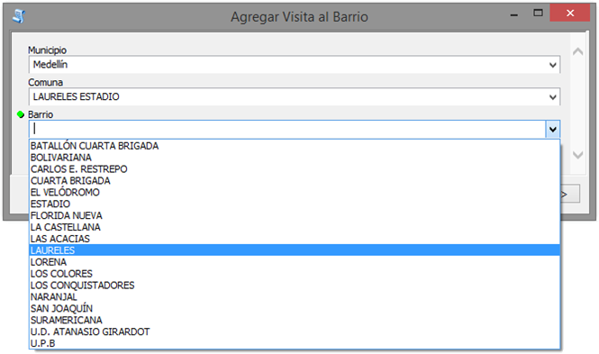

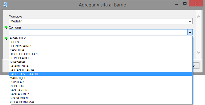

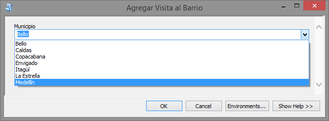

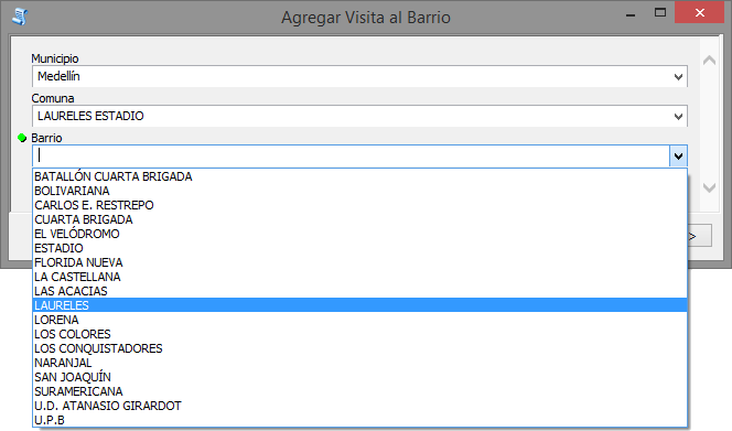

Recently, I was asked to create a tool that offers cascading drop down lists that enables the user to select a municipality and the selection of a municipality should define the list of communes for the second list and selecting a commune should fill the list of districts. A script tool is easy to create and together with the validation code you can implement this kind of behavior.
Let´s have a look at the ToolValidator class that I created:

On line 19 the initializeParameters function starts. This will be called when the tool is initialized and will fill the fields with initial values using some list comprehensions.
Line 27 creates a list of unique values for the municipalities, which is assigned to the list of the filter, and the first value of the list gets selected.
Line 34 creates the list of communes, for the selected municipality, and sets the first commune as selected item.
Line 42 create the list of districts for the selected commune and sets the first district as selected item.
When you change a value (even during the initializeParameters) the updateParameters function (see line 49) is called. In order to avoid that values will be rest some things need to be done.
Lines 54 – 56 read the current select values of the 3 parameters.
Line 58 will check is the municipality is set. If so, the list of communes will be filled based on the municipality. If not the commune and district is set to an empty string.
Line 61 checks if the commune is set. If so and the value is part of the list created based on the selected municipality, than a list of district codes is created and the names of the districts are retrieved based on these codes. If not, the commune is set to en empty string.
The code works and is pretty fast (not sure what the effect would be when using tables and featureclasses as source for this).
