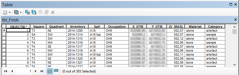

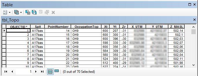

Input data
The input data consists of two tables. One table holds the finds, with XYZ information:
... and the other table hold topographic measurements and information on the soil type (the upper part of a soil layer):

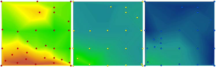

- Create points (XYZ) of the topographic coords per soil layer
- Interpolate the topograhic points for each soil layer and convert to raster (3D Analyst)

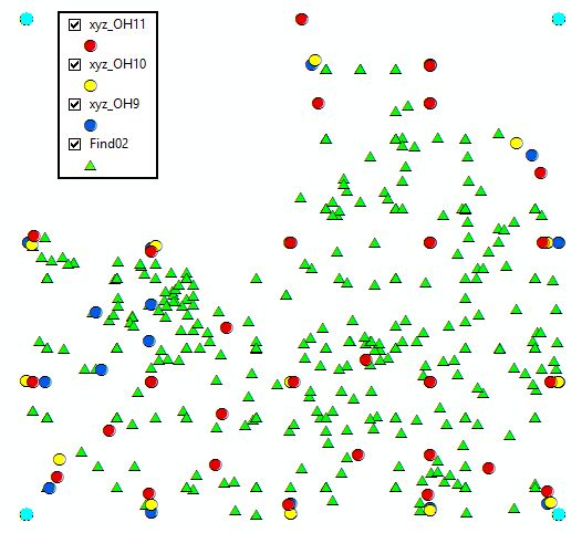

- The finds have an extent a little larger than the topographic information. The topographic information should be extended to match the extent of the finds
Extending the topographic information
To extent the topographic information, I decided to create additional points at the corners of the data (the corners of the union of the finds and topographic extents). These corner points were added a Z value based on a weighted average of the 3 nearest points. Although this is an interpolation method, the influence of this error on the result is minimal.
Topographic points with additional corner points and the interpolation result (TIN, converted to raster):

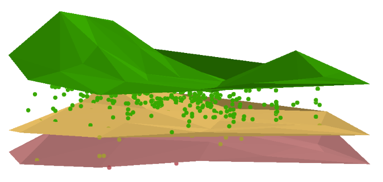

The result
The result of the analysis is the finds table converted to a z-aware featureclass enriched with the soil layer it was found in:
