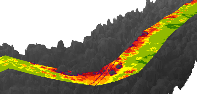

Let’s try and tackle the problem of translating the lowest overhead power lines into a continuous surface. We could use the lines and create a TIN, but we want to have some information outside the power lines, since there may be trees there that interfere with the power line. If you edit the featureclass and create a line, using an offset, the new geometry will be 2D, since the Z value will not be passed to the new geometry. So that’s not an option. Probably the easiest way is to achieve this is using some python code.
What we want to achieve is creating points perpendicular to the power lines, with the Z value of the overhead power line. Although we could use the method described in my blog What if you need to create a 3D line representing the movement due to wind of an overhead power lines? to generate points or lines and generate a TIN from them.

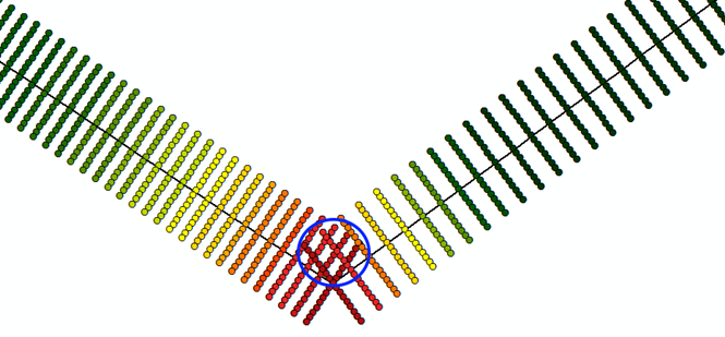

Code used to generate perpendicular points to 3D line:

main()There is a problem when you generate perpendicular points near the towers, when these points start to overlap and have different heights (see blue oval).
In that case you would need to delimit the generation of the points. This could be done by dividing the sections with the bisector of the angle:
This can also be established with some python (may post the tool in the future if there is any interest).
Once you have the correct 3D points, you can create a TIN from them and translate the TIN to raster.
