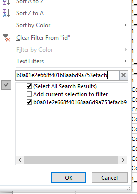

3. Input the itemID in the search bar in excel

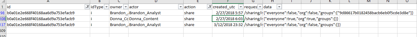

4. Filter the action column to view all share actions
5. Look at the data column and determine which event updated the sharing to everyone:true.
Notice it appears that Donna Content username shared the item publicly right after Brandon Analyst shared with a specific group.
