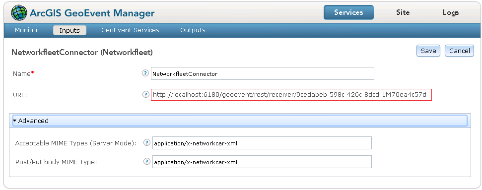

After adding the Verizon Networkfleet input into GeoEvent Server for the first time, it is time to test it. This can be done without waiting for the actual data to come from the Verizon Networkfleet server and it is a good preparation step to ensure that the internal network behind your organization firewall is in a ready state. The UI of the Verizon Networkfleet input should look similar to the illustration below:
Highlight the string value next to the URL and copy the string from localhost to the end of the long GUID to the clipboard (e.g. by using ctrl-c on the keyboard).

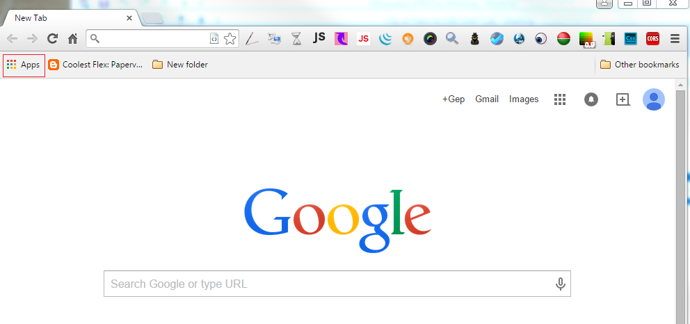

Using a web browser like Google Chrome or Mozilla Firefox, you can simulate data -- Chrome will be used in this example. Launch Chrome then click on the Apps button in the upper left corner.

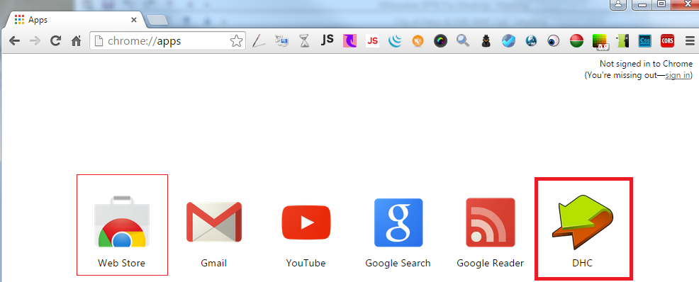

If you already have the DHC app then it will show up on the browser. Otherwise click on the Web Store, search for the DHC app, and add it to Chrome.

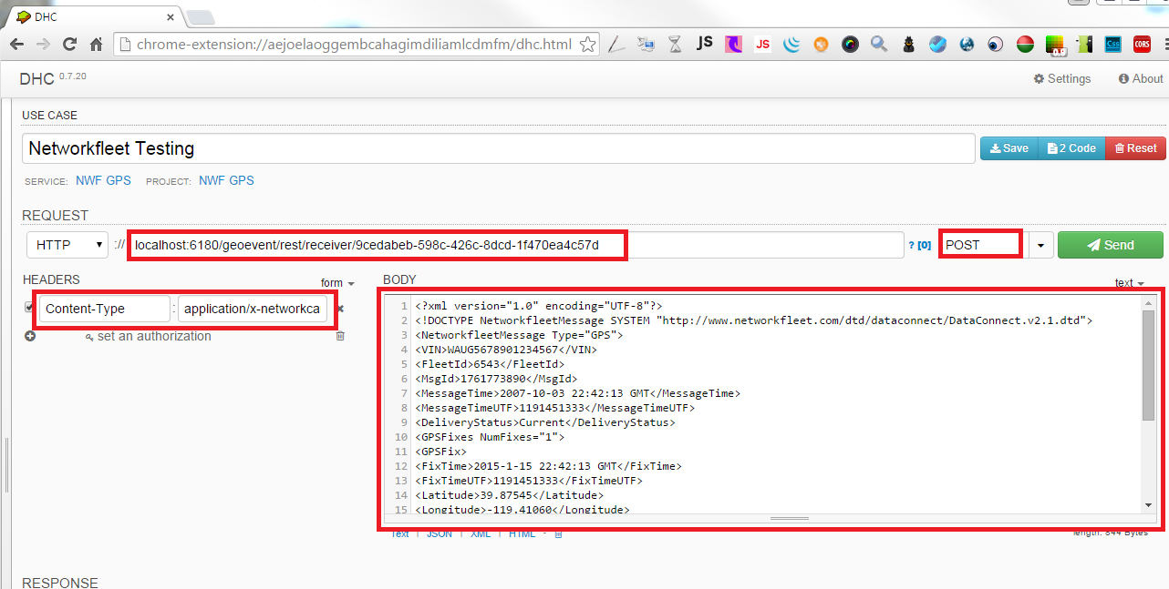

Click on the DHC app, Chrome will open another browser window. Fill in the DHC input as shown below:
- Set the REQUEST to HTTP or HTTPS and POST
- Paste the URL copied from the Verizon Networkfleet input into the input box next to HTTP -- if the HTTP is selected then use 6180 after localhost or 6143 for HTTPS. For HTTPS the browser should accept the certificate from the GeoEvent Server instance otherwise posting will fail.
- Set the Content-Type to application/x-networkcar-xml
- Copy the test XML from below into the BODY

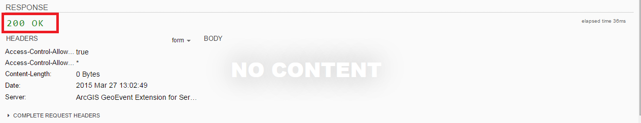

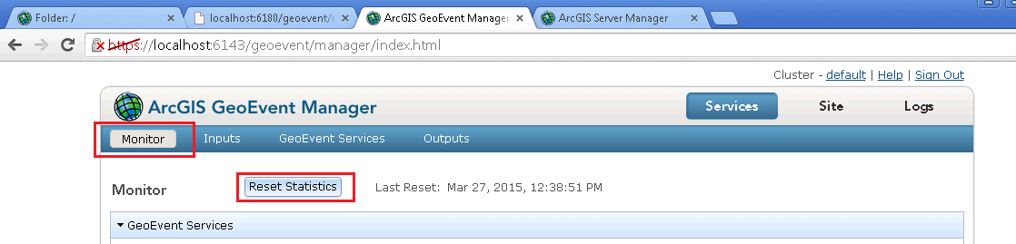

Before clicking the Send button, open another Chrome window and log in to GeoEvent Manager and navigate to the Monitor page. Click Reset Statistics to make sure all the counts are set to 0 and ensure the Verizon Networkfleet input is started. In the DHC app, click Send.
If all goes well the DHC app will show 200 OK response and the Verizon Networkfleet input count will increase on the Monitor page in GeoEvent Manager.
