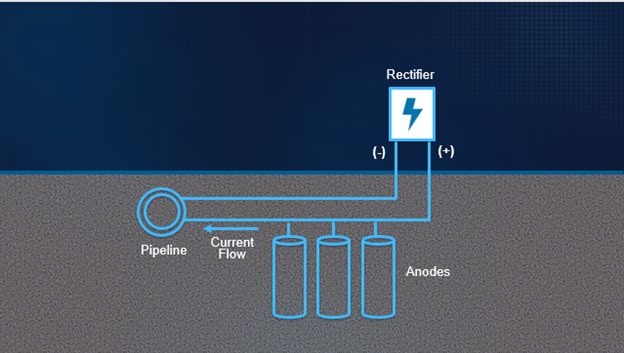

Impressed Current Cathodic Protection
Charge It
Impressed-current cathodic protection systems are typically used to protect large pipe systems such as transmission pipelines. The rectifier inserts direct current (DC) voltage into the cathodic protection system. A rectifier cable connects the rectifier’s positive terminal to the anodes within the anode bed. A second rectifier cable connects the rectifier’s negative terminal to the pipe system.

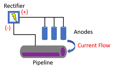

The Electric Circuit
The foundational concept to keep in mind when trying to understand cathodic protection is that the components of a cathodic protection system are connected to form an electric circuit. If the circuit is broken, then the metallic pipe system components will lose their protection and the rate of corrosion will accelerate. If not corrected, the pipe system components will weaken and eventually fail.
Soil Is A Conductor
With cathodic protection, it is important to remember that the soil between the anode and the metallic pipe acts as a conductor. The soil as a conductor of electricity completes the electric circuit connecting the anode to the metallic pipe.

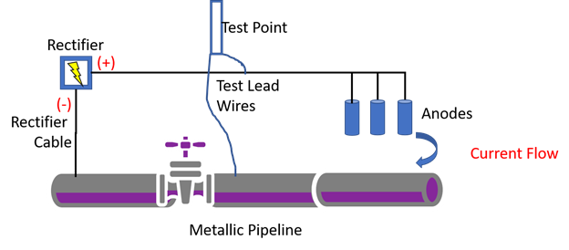

Material Type Matters

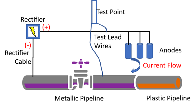

The material of the pipe system components is critical to a cathodic protection system. Some materials such as polyethylene (Plastic PE) are non-conducting and act as insulators. These insulating materials break the electric circuit.
Cathodic Protection System With Insulating Plastic Pipe

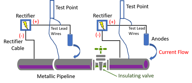

In addition to plastic pipes and plastic components acting as insulators and breaking the electric circuit, metallic components can be manufactured so that they, too, can be insulating devices or junctions.
Cathodic Protection Systems Separated By An Insulating Valve
