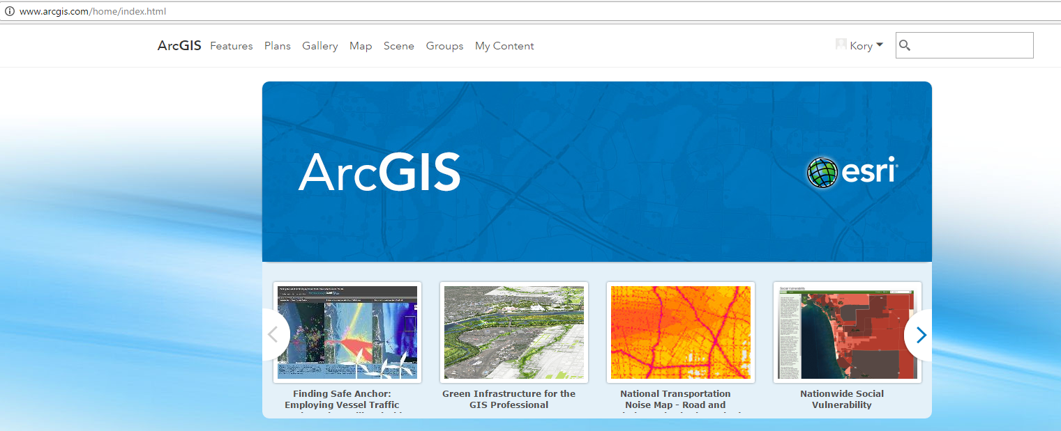

If you sign in to arcgis.com and the page shows you as signed in but the URL still says www.arcgis.com/home/index.html, you’re using a public account and you won’t be able to use this to license Pro. You need to log in using the Named User account associated with your ArcGIS Pro license.

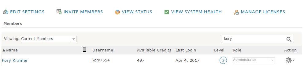

When signed in, go to the My Organization tab and verify your Role. Here we see that I am an Administrator.

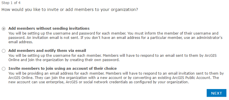

The Add or Invite Members wizard gives you three options.
The quickest way to go is to choose ‘Add members without sending invitations’. With this option, you set up the username and password for each member. You must inform the member of their username and password. More details about the other ways of adding members to the organization can be found in the Invite and Add Members documentation. ArcGIS Pro requires that members have a Level 2 license.

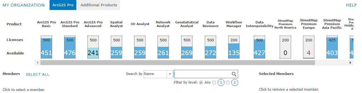

ArcGIS Pro licenses can be managed from this page. You can assign licenses individually by clicking “Configure licenses” next to the user’s name or collectively by clicking on the member names to add them to the Selected Members list and then clicking the Configure button. Then you can assign ArcGIS Pro at the Basic, Standard, or Advanced license level and assign ArcGIS Pro Extensions.
