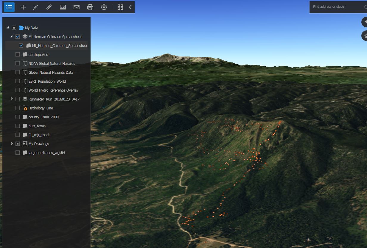

One of these tools is the 3D scene viewer in ArcGIS Online. What if you were to use an adventure or experience that you or your students have had to help them to think in these dimensions? For example, one of my colleagues likes to go paragliding. He gave me the data he collected on a few of his paragliding runs, and since the data was in an Excel spreadsheet, I could easily bring it in as a CSV file into ArcGIS Online. From there, I created a service and added that service to the 3D Scene Viewer, shown below, with a link to 3D Scene Viewer so that you can interact with it. This is on Mount Herman along the Colorado Front Range, and that mountain in the distance is Pikes Peak.

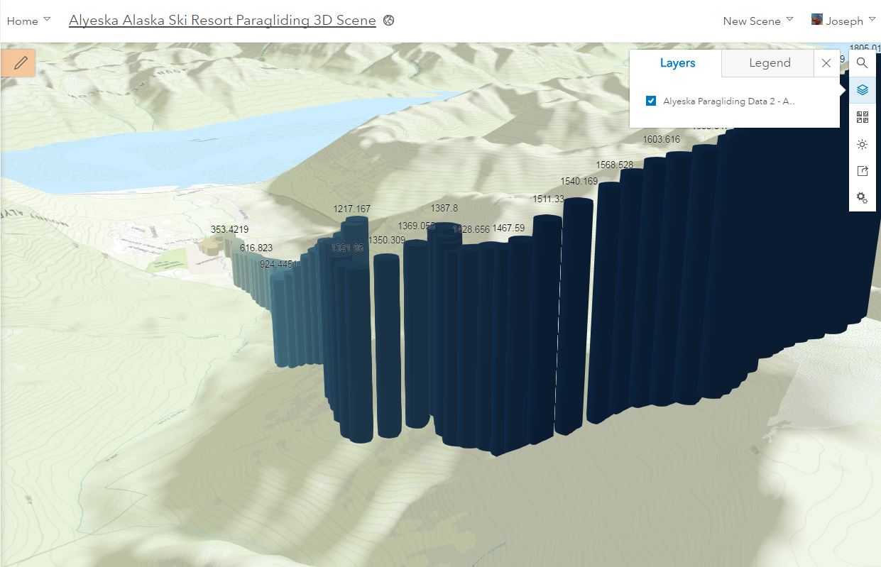

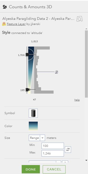

I used the 3D cylinders on altitude to map my colleague's position. You can adjust the style, color, and size, and the elevation mode (relative to ground, on the ground, absolute height) as needed to make your 3D scene as realistic as possible and to meet your educational goals. For example, here are the symbols I chose for my colleague's run down the ski slope at Alyeska, Alaska:

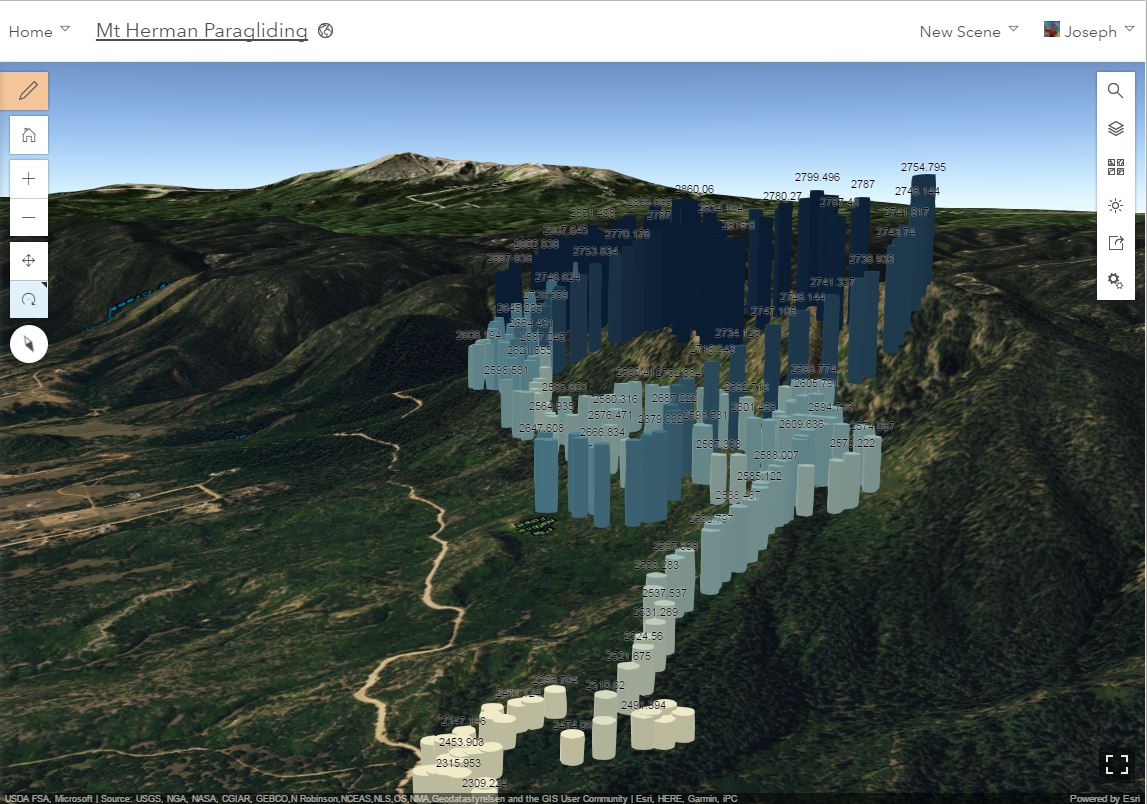

The results are shown below. You can see that I also labeled the cylinders by elevation and color-coded them with the same variable. The URL is here so that you can interact with it.
