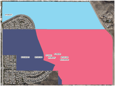

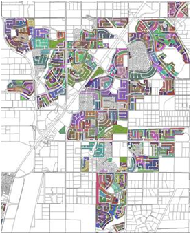

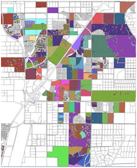

An example of what can be accomplished in an afternoon using my techniques is shown below.
Case shapes based on original parcel numbers - 26,105 parcels countywide

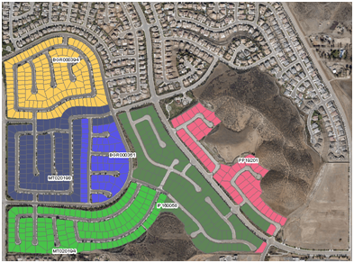

Case shapes based on subdivision and lot description parcels - 124,643 parcels countywide

Without going into a lot of detail, here are the broad steps I followed to transform the case shapes below that were created from parcels that existed at the time of application before the property was subdivided. None of the shapes below represent the true boundaries of the case applications.

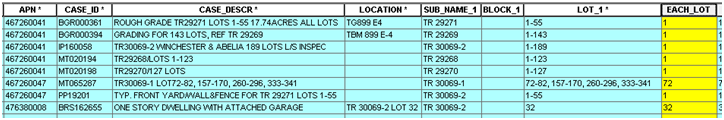

1. For the Assessor’s parcel feature class, which must be within a geodatabase, I concatenated the separate fields that make up the subdivision and lot description or each parcel into a single field using a standardized description format

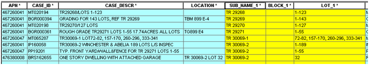

2. Extract the LMS case number and field(s) containing each case’s subdivision and lot descriptions into a file geodatabase table
3. For the LMS data select the sets of records that contain the most common forms of a subdivision and lot description from within a field that may contain one.
4. Calculate the subdivision and lot portions of the description into separate fields using Python parsing methods.

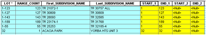

5. Summarize all unique values in the field containing the lot portions of the description into a new summary table in the geodatabase containing the LMS data.
6. Add the set of pairs of fields required to store all of the lot ranges that can be parsed from the original lot description and parse the range values into them. This is probably the hardest step, depending on the number of lot descriptions you have and the format variations you encounter.

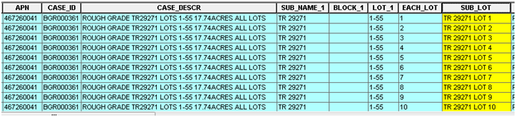

7. Run a script (see the end of this post for the script code) that populates a new table stored within the LMS geodatabase with the expanded set of records required to populate a new field with each individual lot number defined in the ranges of every lot description field pair in the summary table. This step makes all of the time spend doing the previous step well worth the effort.
8. Summarize the original LMS case data into a new table using the Summary Statistics tool so that it only has one record per case containing the case number and the legal description fields added in step 4 at minimum, although you can include as many fields in the output that you want so long as they do not cause more than one record per case to be created in the output.
9. Make the summarized LMS case data created in step 8 into a Table view and join its lot description field populated in step 4 with same field contained in the expanded table populated by the script in step 7.
10. Export the joined LMS case data table into a new table stored in the same geodatabase as the parcel feature class. With ArcGIS 10.3.1 and above this will cause the case records to expand to cover all of the records required to describe each individual lot for all of the case subdivision and lot descriptions.
11. Add a new field to the export output of step 10 and calculate the concatenation of the subdivision name with the field containing the individual lot values of each record into a new subdivision and lot concatenation field. These concatenated descriptions must match the format of the Assessors subdivision and lot concatenation field populated in step 1.
12. Make the Assessor’s parcel feature class into a layer and join its concatenated subdivision and lot field to the new concatenated subdivision and lot field of the expanded case record calculated in step 11.
13. Export the joined Parcel features to a new feature class to expand the set of parcel features to cover every individual lot in every joined case.
14. Here is the final result. This is a true representation of the parcels and property each case actually should have covered.
The outcome is an LMS case feature class that has features in the shape of each and every parcel that matched the lots described in the case’s original overall subdivision and lot description. The more cases I need to be process, the more efficient this process becomes. I have applied it to nearly 1 million LMS cases in an afternoon and created a parcel output that would have required approximately 5 years of man hours to manually enter all of them individually into the LMS system.
