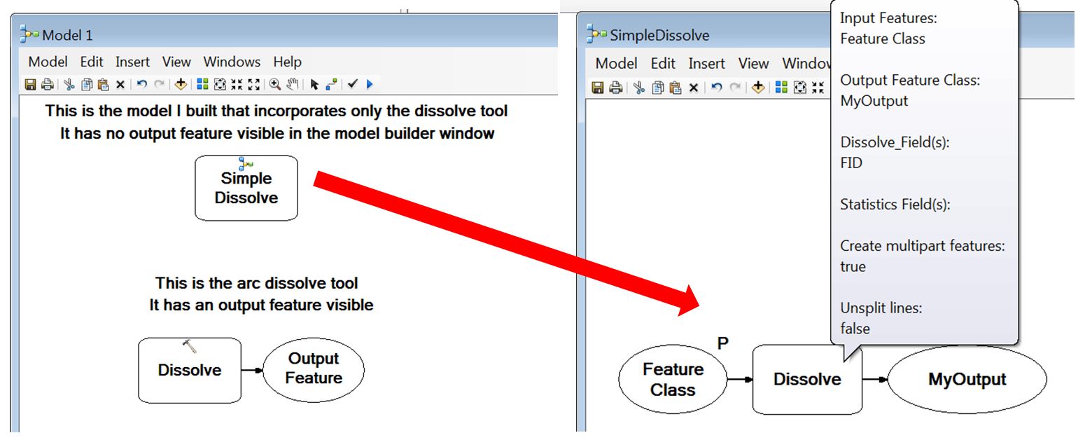

Can someone please tell me why when I drag tools into model builder they have an attached output variable. But if I create a tool in model builder that uses the same esri tool and drag that tool into model builder I see only the tool and not the output variable? The picture attached has an example, but I got the same result from a much more complicated tool I built that I am having difficulty iterating and I am wondering if this might be an issue.
