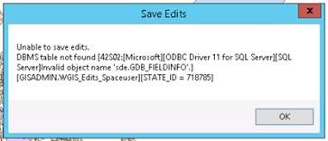

I'm currently attempting to complete a version upgrade of a SDE database on a MSSQL server and while the core database and feature classes upgrade successfully, when attempting to re-implement versioned editing the edits are failing to save.

The error message we are receiving when attempting to save edits is as follows:
