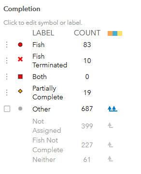

I have a feature layer in my web map whose attributes will be edited by users. The fields to be edited have domains set up, so I know what values to expect. I want to create the legend for the expected combinations of data, but since the layer starts out with all the fields having their default attribute, I cannot do that without editing a few of the features to make sure they all the combination variants. Is there any way I can create the legend without putting dummy data in the layer?
My Arcade code looks like this

with this legend as the result:
