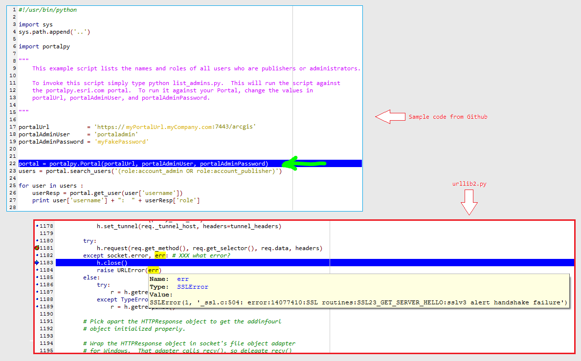

However, I have just started to look into using portalpy for automating some administrative tasks and I am having troubles logging in via Python 2.7. I found some code from the samples to login to Portal and list all of the admin users. Unfortunately, I cannot connect. I keep getting the following error: "error: 14077410:SSL routines:SSL23_GET_SERVER_HELLO:sslv3 alert handshake failure"
I have done some reading online, and I have seen things about ssl3 and the Poodle virus, but I am unsure if that is related. Has anyone else dealt with this problem in your code?
