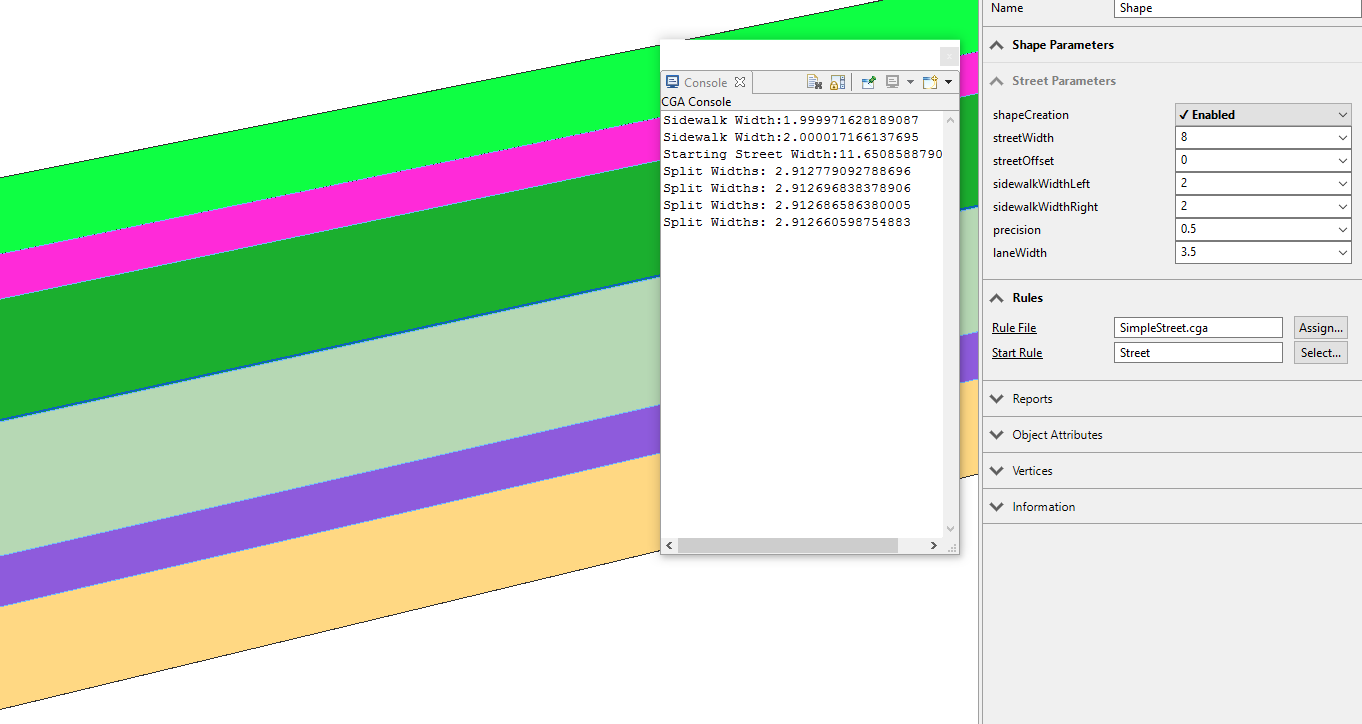

I'm running into something I can't wrap my brain around - I'm trying to split a street shape and it looks as though its adding in 4 extra meters - assuming its because of the default sidewalkWidthLeft and sidewalkWidthRight. This is complicating my splits a bit and when I look through the ESRI rules for streets I can't see where this is being accounted for. Am I missing something? Shouldn't this rule put in 4 equal splits between the sidewalks? The console reports 4 equal splits.
lenAlongV = geometry.dv(0,unitSpace)
# Street
@StartRule
Street --> print("Starting Street Width:" + lenAlongV) # Print Width
BuildStreet
BuildStreet-->
split(v, unitSpace, 0) {'0.25:RandomColor print("Split Widths: " + lenAlongV)}* # Print Split Widths
RandomColor-->
color(rand(0,1),rand(0,1), rand(0,1))
Sidewalk --> print("Sidewalk Width:" + lenAlongV) # Print Sidewalk Widths
RandomColor<SPAN class="line-numbers-rows"><SPAN></SPAN><SPAN></SPAN><SPAN></SPAN><SPAN></SPAN><SPAN></SPAN><SPAN></SPAN><SPAN></SPAN><SPAN></SPAN><SPAN></SPAN><SPAN></SPAN><SPAN></SPAN><SPAN></SPAN><SPAN></SPAN><SPAN></SPAN><SPAN></SPAN><SPAN></SPAN></SPAN>Instead I'm getting this
