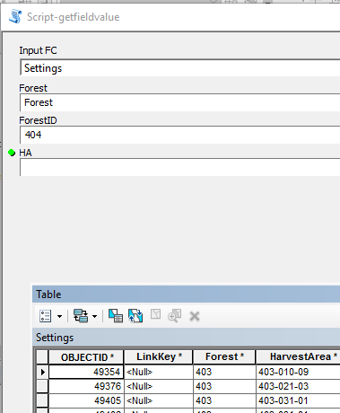

I'm trying to use the ToolValidator function to update the content of the drop down lists. I've followed the steps fromΒ https://blogs.esri.com/esri/arcgis/2011/08/25/generating-a-choice-list-from-a-field/Β Β but need to take it a step further and populate the 'HA' drop down list with the values in the 'HarvestArea' field that start with the 'ForestID'.Β
Any helpΒ on how to format this in the ToolValidator script (see below) would be much appreciated!Β
